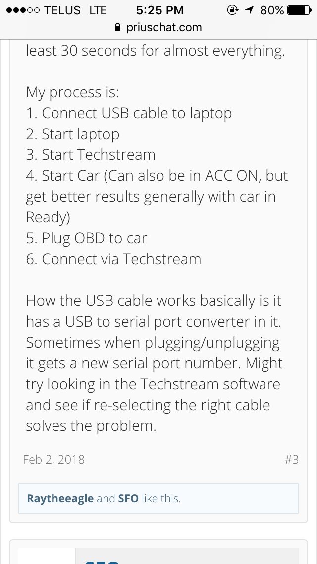

    I did it myself with Techstream. I found it very finicky, had to keep trying to get it to connect but it worked. The instructions are attached.

    good stuff! thank you! now I have to find a techstream :)
