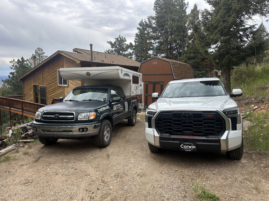

    hi there.
    I recently got a 2022 tundra and I would like to move my camper to this truck.
    has anyone else done this and what airbags would you guys recommend if so?

    time to give the 1st gen a break from camper duty.
