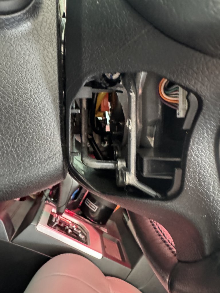

    Trying to install the MESO steering wheel blackout kit. Are those two T-25 bolts on the side just extremely tight? Not budging but also have not gone crazy on them yet.

    Yes they’re tight

    They're good n tight. Don't strip em. Use a ratchet with a small extension and correct bit.
    Also be sure to disconnect your neg battery and wait about 5-10min. Always disc batt when dealing with airbags. I'm sure you know that though :thumbsup:

    Yep, disconnected the battery and set a timer for fifteen minutes. I have the right bit so I will try a ratchet.

    if they have never been loosened - they are tight - but if your like me and broke the clock spring, and had to take it apart again - they get easier
