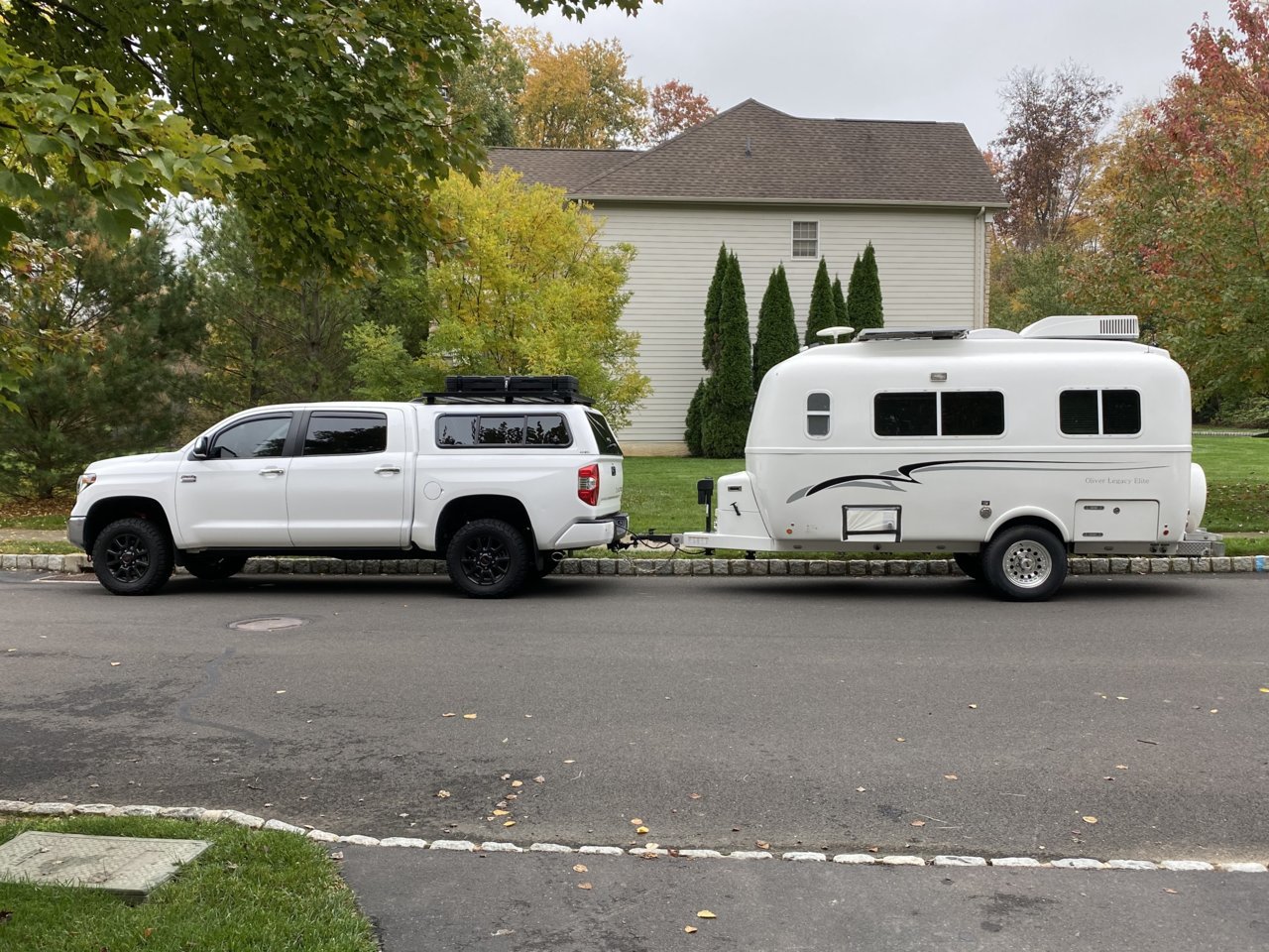

    Firestone airbags with daystars... rides perfect and level @20lbs when hooked up.... keep 5lbs in them when not towing and that gives me about 1” of rake... Makes towing a breeze74544BD5-EB7E-48AD-AAFE-7A3599045042.jpg
