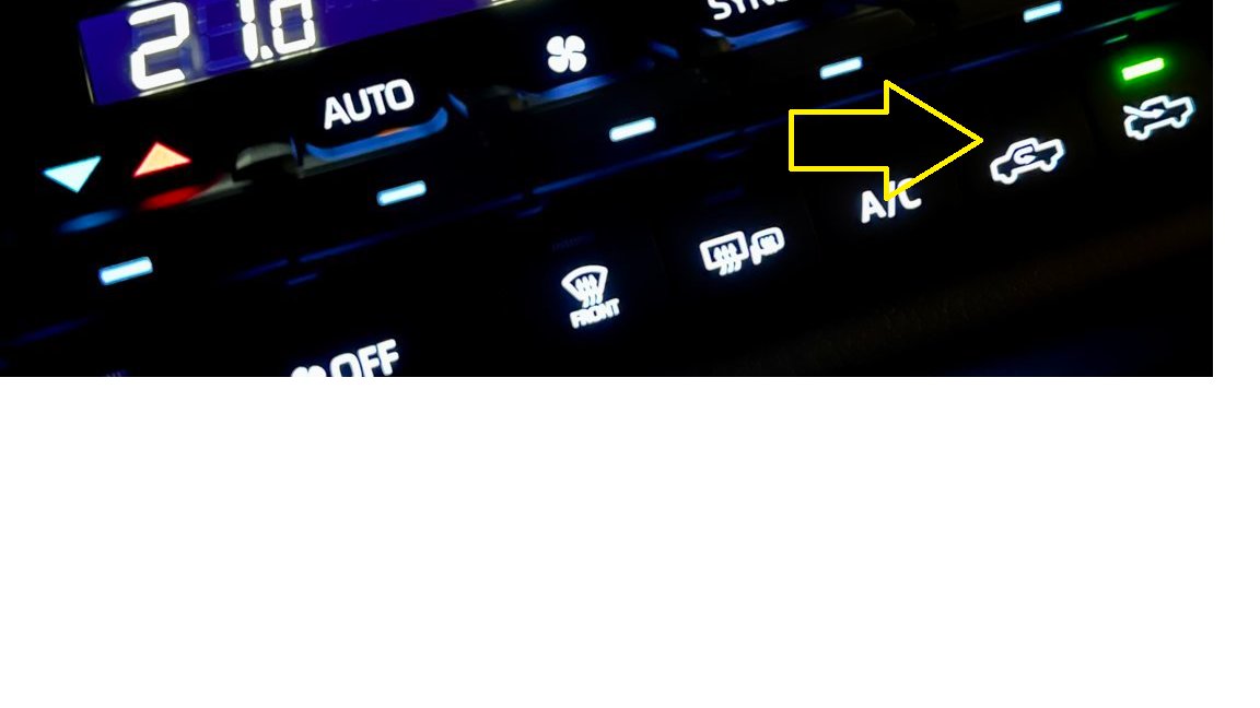

    I can't seem to find an answer...does anyone else's truck switch from recirculate to outside air without you pressing the button? My truck will inevitably switch to outside air if I press the recirculate button. However, if I press the outside air button, it will stay there happy as can be. It does this both on AC or heat, and it does it whether in auto or not. Seems my truck wants outside air all the time, regardless of what I want.
    I do have an appointment with my dealers' service department soon and will inquire with them as well.
