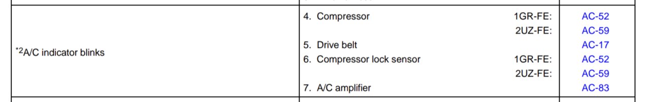

    Actually, if you read the pressures by bypassing the pressure switch to engage the compressor, then your charge level may be ok.

    Per FSM

    Thank you for this. It's dumping rain outside but will check this soon. What is the amplifier BTW?

    It's the dash controls basically.
    They used to be separate but now are an assembly.
    FYI they are vehicle, trim and options specific, so getting an exact matching replacement would be necessary. If it's needed.

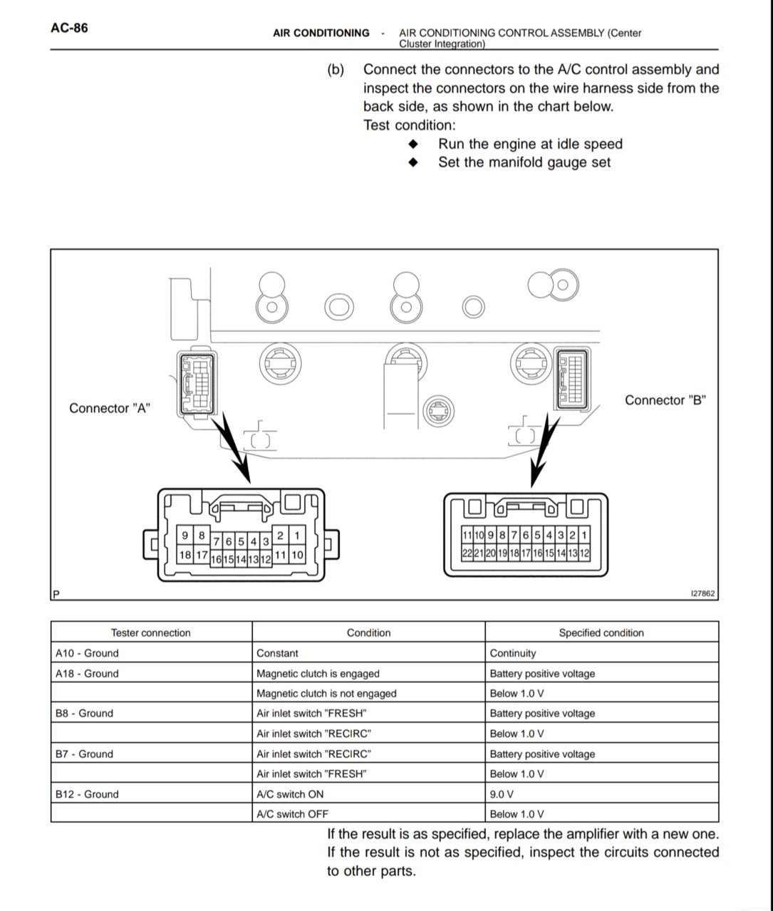

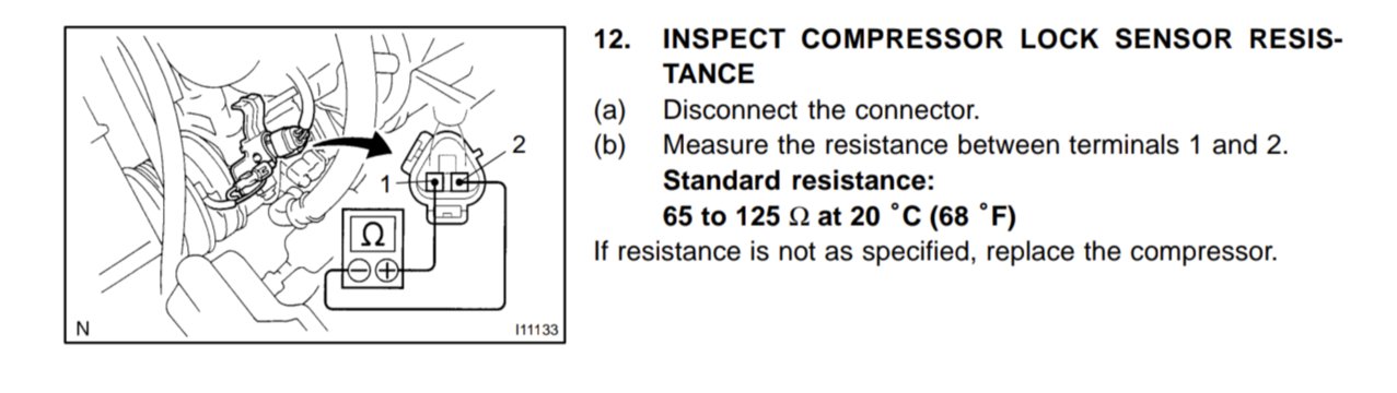

    Good morning, just putting this out there because this helped me. I'm working on my 06 Tundra, and the compressor engages and runs for about 5 seconds then disengages. The AC light starts blinking. Went through the above check sheet, and B12- Ground doesn't give me 9 Vdc, found the compressor lock sensor shorted out. Temporarily wired a resistor in place and system works as should. Will still need to replace the compressor of course.

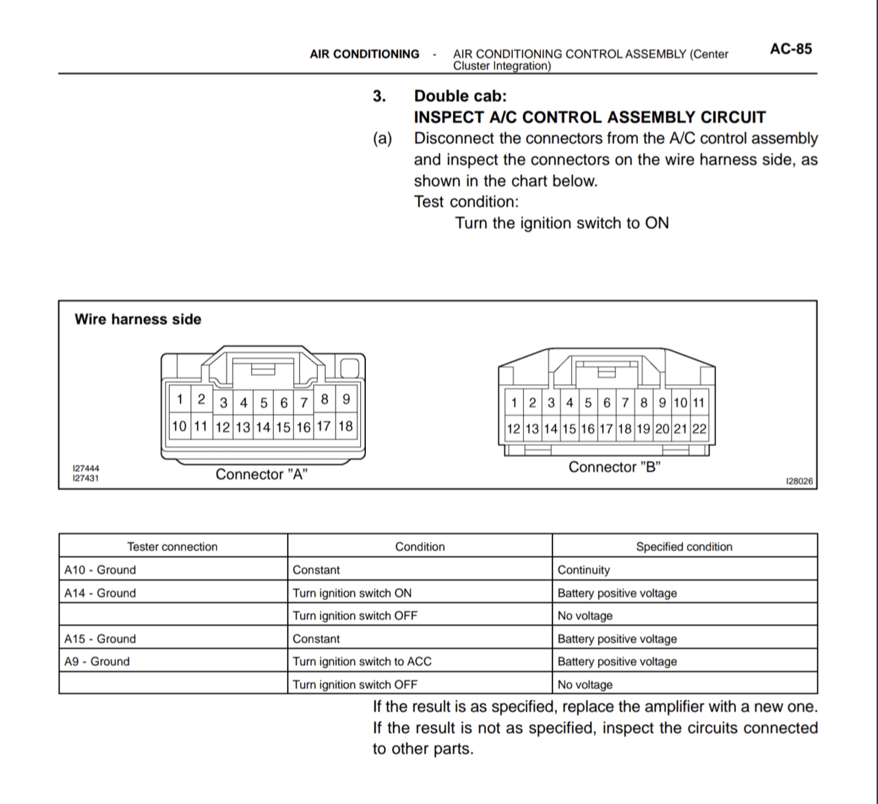

    I am not getting any voltage at A14. Anybody have a diagram to know where that comes from?
