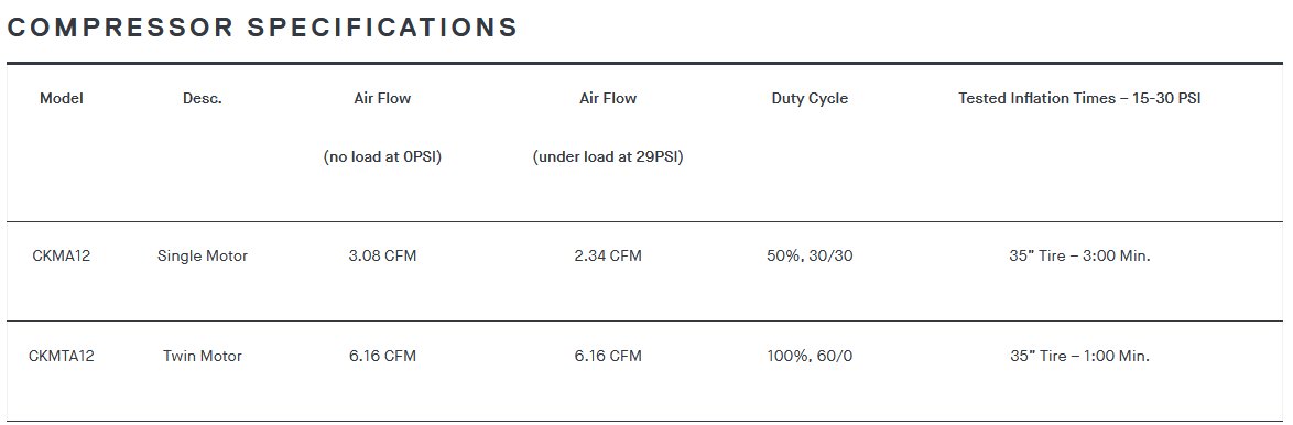

    You'll want to consider the duty cycles. I like Makita tools but I was quickly turned away by the duty cycle. There's no information I could find on the flow rate in CFM on the Makitas, but I'm sure it's lacking in comparison to the ARB. That little guy is better suited for bike tires.
    Here is the duty cycle of Makita:
    Here is the duty cycle and inflation specs of two of the ARBs:
    With the single ARB, you can run it in duty cycles of 30 minutes, then it needs a rest period of 30 minutes. The twin can be ran at higher intervals since it is 100% duty cycle. Also note the flow rate and inflation times. The Makita isn't anywhere near that.
    If you run air compressors longer than their duty cycle, they're bound to overheat and malfunction. I've done that with a cheapo slime compressor before.
    I don't have any experience on the Dewalt 60v but I looked it up and it's size would be a concern for me. One thing if you're going to be using it to air tires offroad -- the batteries, inverter for charging, and the charger itself will just take up more room. The ARB compressors are DC.
    Another option is to get a CO2 bottle from somewhere like AirGas. Those fill up tires super quick but take up space. I use one on occasion, but my truck is getting a twin ARB once I pickup the mount.
