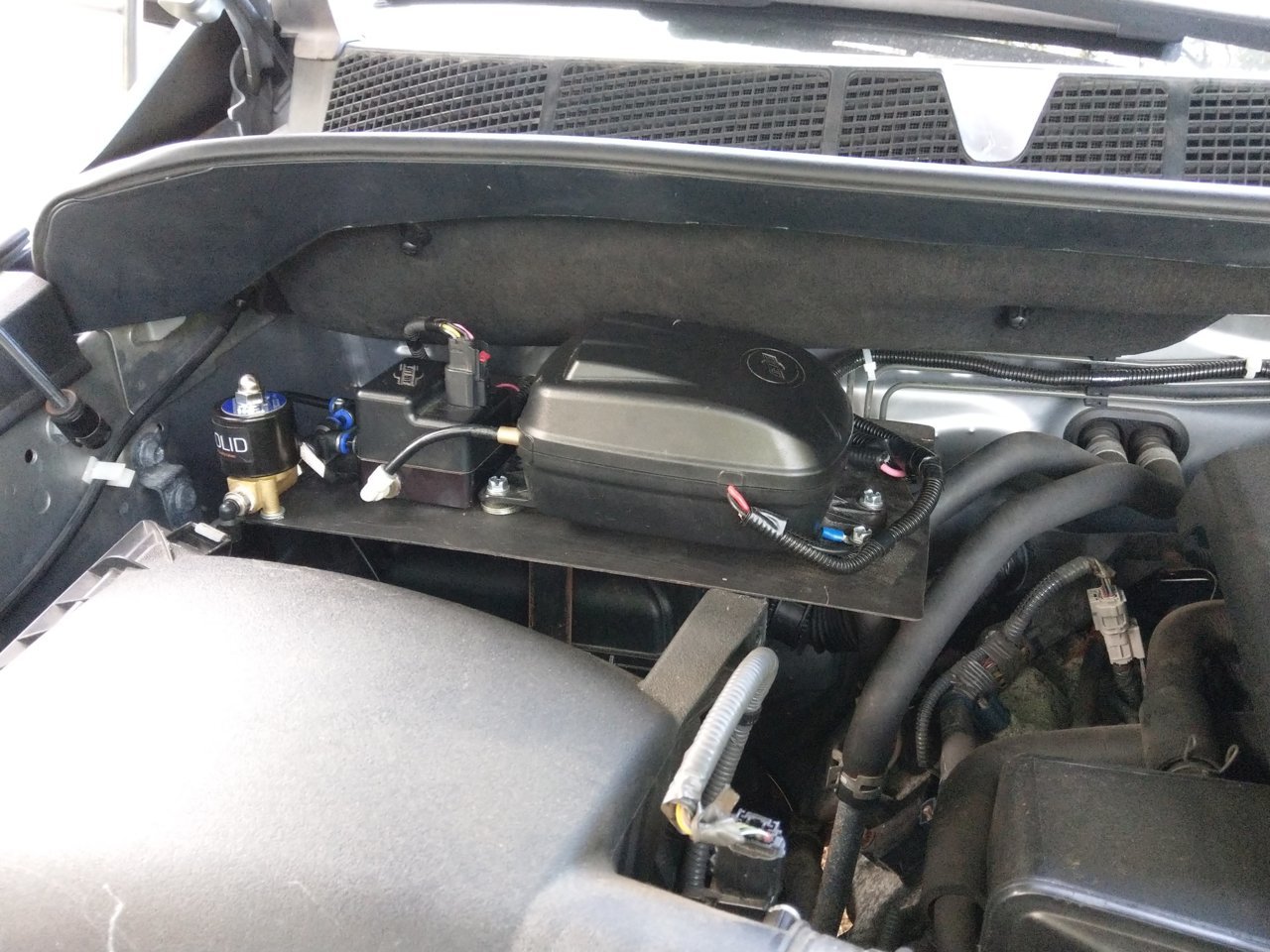

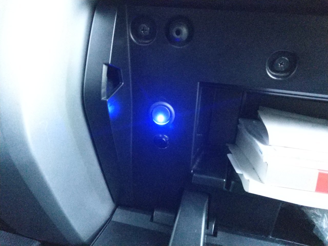

    South Shore, MA
    2014 Crewmax Limited
    Mine was in a toolbox in the bed when I bought it, made a mount and moved it under the hood. Also added a switch and valve to let the air out when I'm not using them.IMAG1105.jpg IMAG1107.jpg
