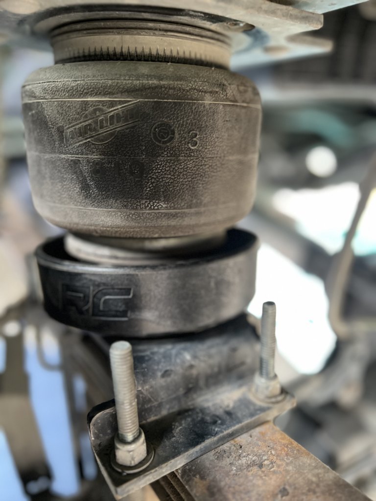

    Cradles are a good idea. Like said, it takes stress off of them when lifting. It doesn’t matter what lift you have in the rear (0”-4”) as long as you’re using stock leaf springs because the cradle will be on top of the leaf spring where as the lift blocks will be between axle and bottom of leaf springs. And aftermarket lift leafs would be the same as in the cradle will be on top also. IMG_7042.jpg
