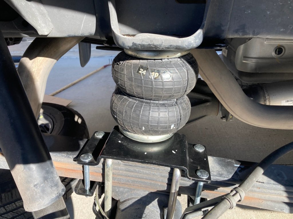

    Towing 20' small camper that does not seen to require a WDH as it towed rather well on the highway. Added a Sway Control and Air Bags to try and control things a bit as the wife gets Motion Sickness easily.

    Read the manual and get a tongue weight. You may be good, you may be surprised. The porpoising is a sign you could use one, but the numbers always tell the truth.
    Regardless, as stated previously, if you aren't using a WDH, I'd inflate before.

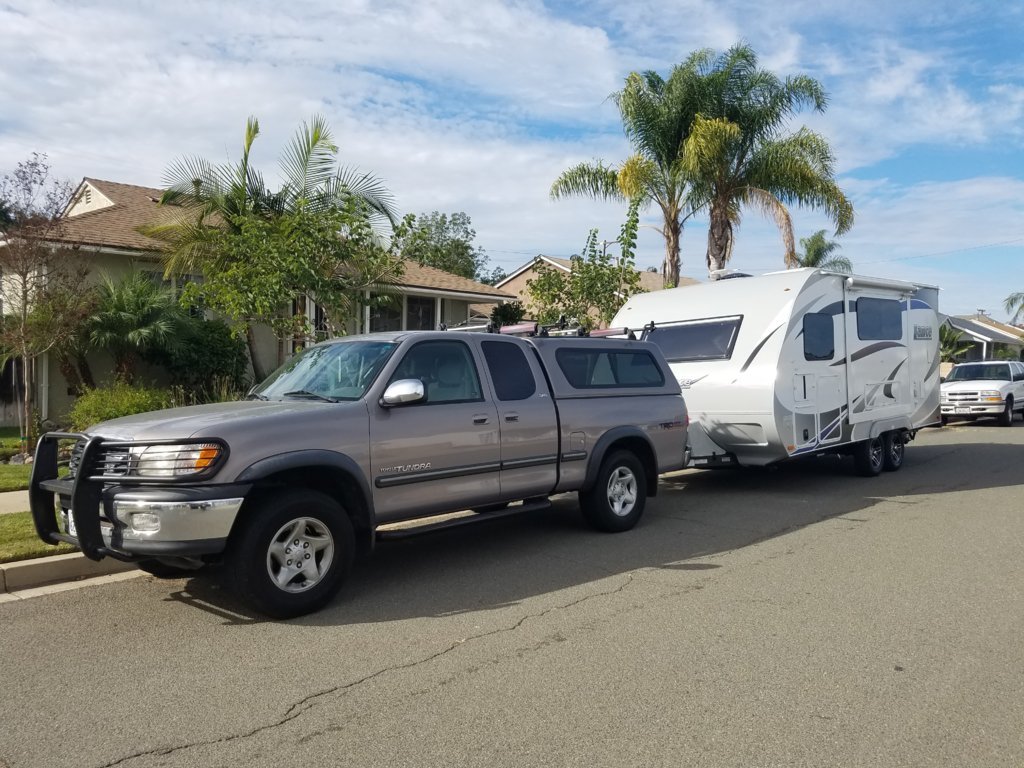

    I'm genuinely curious, if there's no need for a WDH why would it need airbags?
    If it's working well for you that's awesome, this just seems kinda backwards to me.
    When I got my trailer (similar size but a little heavier) the first couple of trips were sans WDH and had a lot of porpoising &/or conflicting bounce between truck & trailer. Added the Andersen WDH and what was two separate objects hooked together now felt more like one cohesive unit.

    Happy Wife, Happy Life!
    Hey I'm 62, of course I have a little rear end dip. :rofl:
    Ohhh, you meant the 1st gen pic huh? Yeah that was before deciding I needed the WDH.
