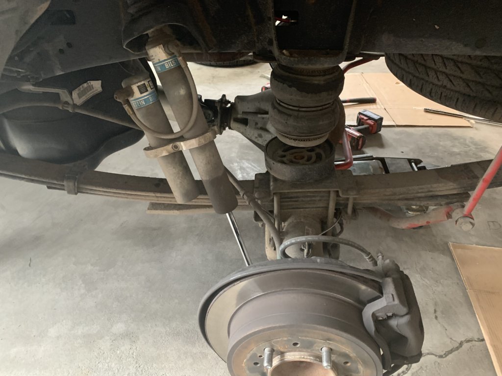

    Ideally, that is correct. But airbag kits are designed with an off the shelf bag applied to many applications instead of a custom bag for each application. So while the shock absorber should limit axle articulation, it doesn't mean that the bag was designed to meet the same spec. I believe there was a new guy here not too long ago that had his airbag fail; the top plate mounting bolts separated when the vehicle was put on a lift. They were Airlift bags, if that makes any difference. Below is my bags, cradles, and (then) stock leaf pack with Bilstein 5160's which don't have much more travel than stock (25.7" extended length vs ~25" stock IIRC). Lots of room underneath the bag, and the cradle takes up about 3/4".

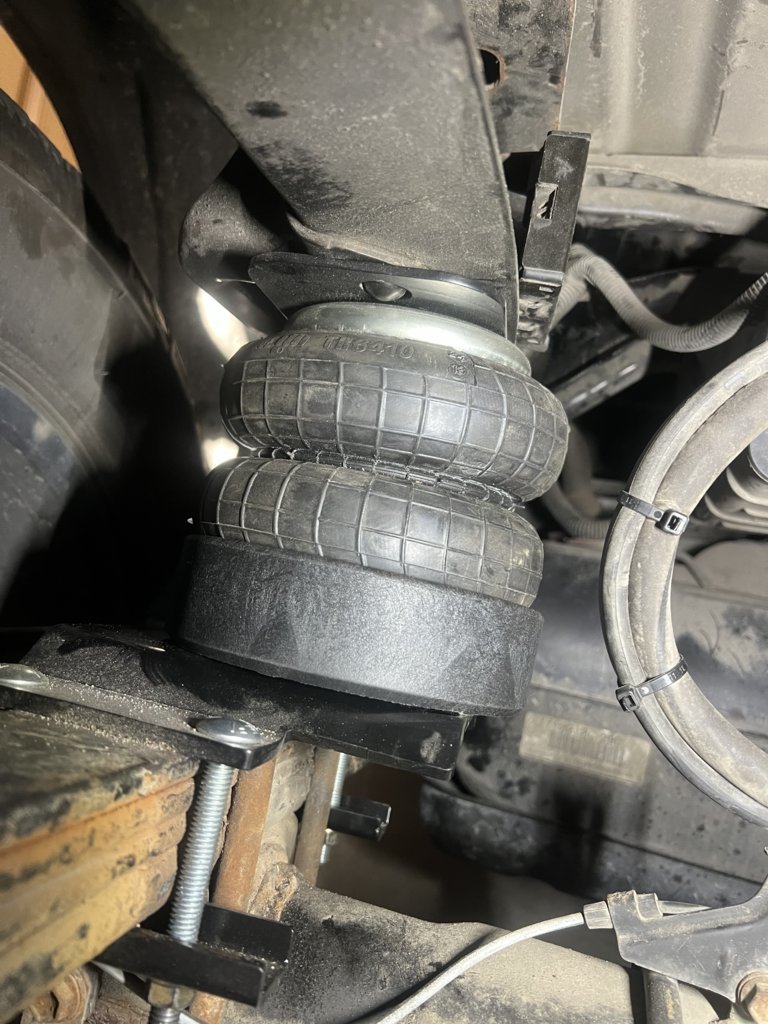

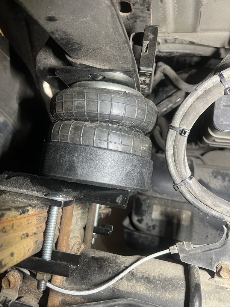

    So I installed the cradles today. I notice that the rubber part of the airbag makes contact with the cradle. Is this normal? My worry is that the rubber contacting the cradle could cause the bag to wear through. In these two pictures the airbags are at 10psi and 20psi. I’ve been running them at 10psi so the truck doesn’t sit high at the rear.
  15. Oct 28, 2024 at 6:23 PM
    ColoradoTJ
    Feb 24, 2016
    #2766
    40,232
    That's what mine looked like on the Tundra...until I did a 1" lift.
  16. Oct 28, 2024 at 7:30 PM
    huntertn
    huntertn New Member
    Jun 23, 2019
    #32273
    354
    Steve
    Tennessee
    2008 White CrewMax Limited 4x4
    That’s what mine look like.
