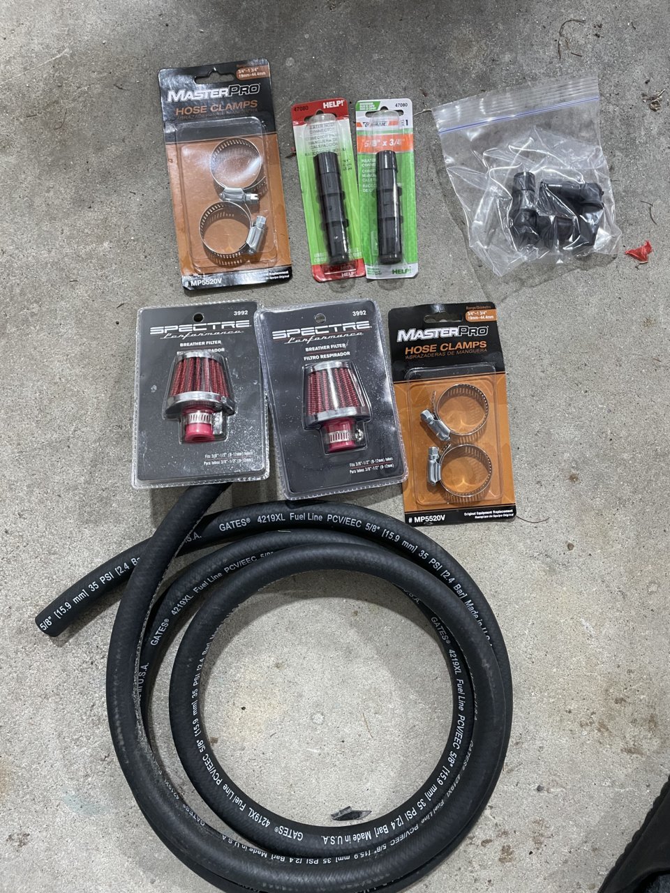

    Edit:Just installed it and the measurements of the tube coming off the pump is 7/8” ID so change accordingly. I still used the 5/8” and just clamped it down tighter
    I haven’t installed it because my back keeps going out. Hopefully this weekend.
    But I bought:
    5/8” ID hose
    4x total hose clamps
    2x 5/8” 90 degree fittings (pump hose to new hose)
    2x 5/8” to 3/4 fittings (for hose to air filter)
    2x breather filters
    4-pack of 1/2” tube straps from HD
    All in $70. I was going to go AN fittings but it’s more money around +$40 depending the fittings you purchase.
