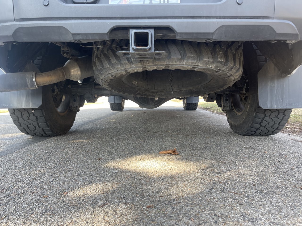

    I’ve got a factory TRD black 20 with a Toyo MT 35x12.5 crammed in there. I cut off the back mounts so the tire sits more tucked up behind the rear axle

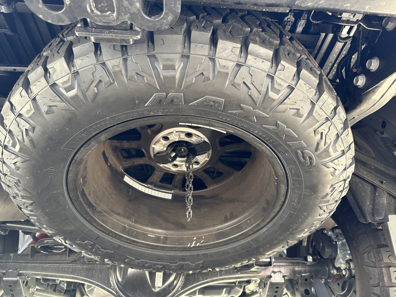

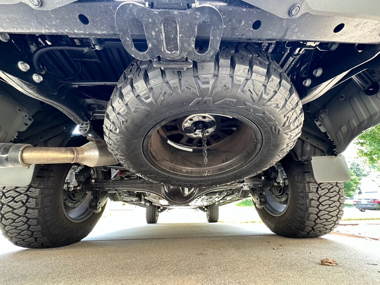

    Just swapped my factory spare with an OEM 20" TRD OR rim and Maxxis RAZR 285/65R20 tire. Fits fully inflated at a slight angle without any modification.
    Eta the Maxxis dimensions:. 34.7"D x 11.6"W

    thanks for the pics, what's causing it to seat at an angle?
    Are there any potential the rim surface would get scratched up?

    There's a lip that snugs up to the factory spare. The larger tire won't fit inside it so it sort of rests on top of it.
    The rim doesn't come in contact with the body so I don't think it will get scratched.
