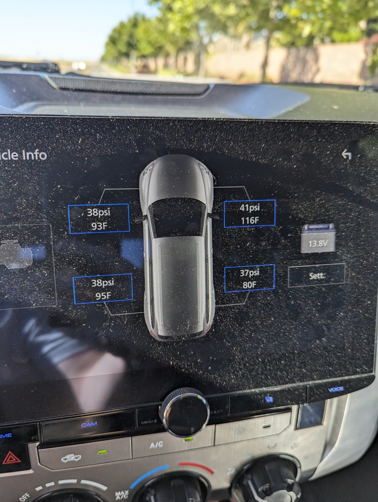

    Interestingly enough, it appears that it maybe updating the tpms's. When i first swapped the tires, they all read around 41psi and 115ish deg...now they've changed a bit, first the drivers side upadted yesterday and now the rear passenger side this morning. PXL_20240605_155222971.MP.jpg

    Well, the TPMS light came on. :mad:
    I swung by Americas Tire, and they tried to program them and they weren't able to read the sensors. Looks like im SOL.
    I tried to do the hold the TPMS button until the dash light flashes, and then drive it around....worth a shot but doubtfull.
