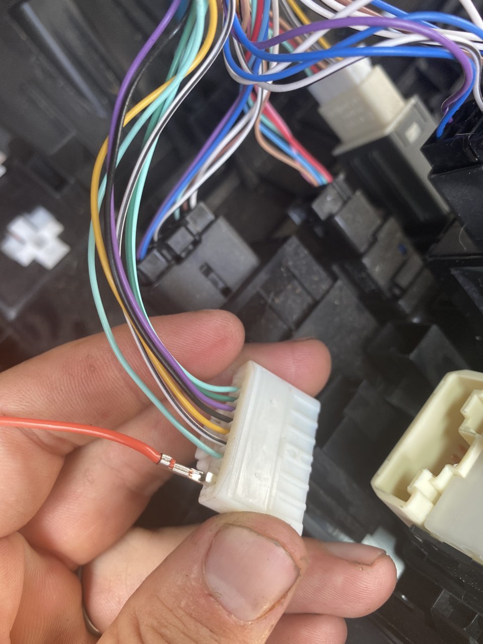

    Got any photos of the switch and wire up? I'm sure it wasn't ll plug in play.

    7D840D9E-C146-4CF6-BA4D-340DDA431B97.jpg B1DFBD28-2750-45DA-BD3C-865EDBEB0CE9.jpg 9B7D7219-5A51-4698-8682-FAD87A9AD881.jpg
    courtesy of @Toshito. It’s as close to it as you can get. Basically they send you a kit with an aftermarket switch(trash) and wiring kit which you can cut the power wires off(oem switch already has power). You run their retrofit signal wires to the oem switch location, replace the oem switch with the new one, and you can remove two wires from the harness Amazon sends you with the replacement oem switch, plug them into the existing harness, and just crimp those onto the signal wire. I know it sounds complicated but once you’re looking at it it’s easy.
    new switch is cheap too:
    https://www.amazon.com/dp/B07Q572QBK
    here’s his thread: https://www.tundras.com/threads/power-folding-mirrors-boost-auto-parts.71874/#post-1916248
    honestly for all the features you get the price is good and they look/work great
