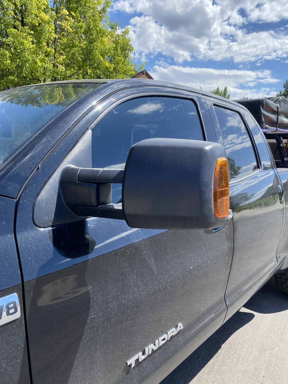

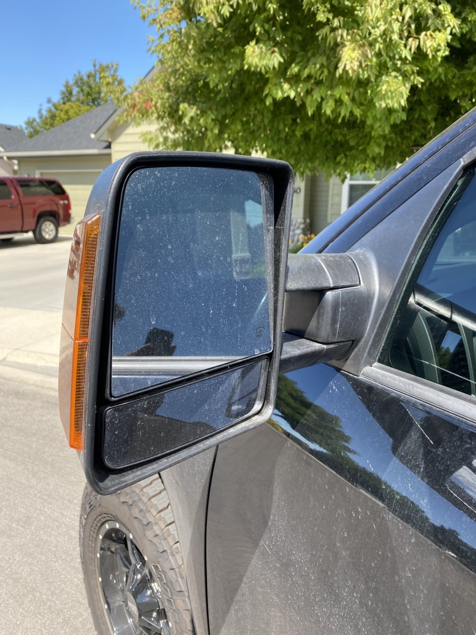

    I recently purchased a 2012 Tundra that has tow mirrors on it. Since buying it, I have learned from my local Toyota service center that the mirrors were aftermarket so the button that indicated folding mirrors is meant for the stock mirrors and these mirrors must be folded manually, however, when trying to fold these mirrors manually I have to pull so hard I feel like they are going to break and I haven't got them folded in out of worry that I would snap some sort of support that keeps them sturdy. Has anyone else had issues with folding their aftermarket Tundra tow mirrors?

    Post pics of the mirrors. There are different ones. Maybe someone will be able to identify them.

    344D7CB2-E3A8-45FE-BF78-657ABAF29885.jpg 934A882E-7A3A-4166-98B2-70111FDC9164.jpg

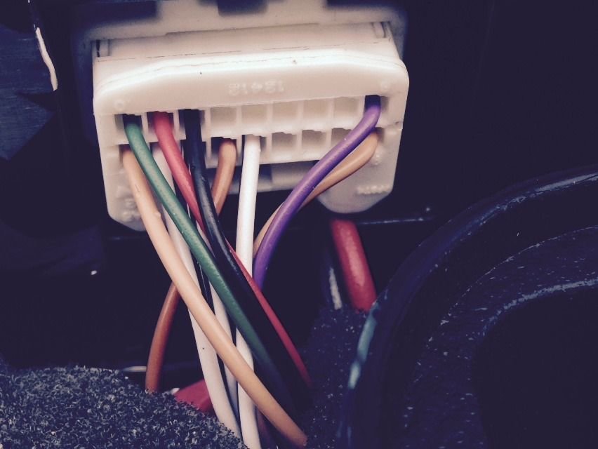

    Check and see if there are more wires to the mirror than just what is in the plug.
    I have no idea if those aftermarket mirrors come with a stock plug or if everything has to be tapped into oem wiring..
    You can pull the door sail off and see one side of the plug.
    It literally just pulls off., at least it does in my 2014..
    D7816C05-2B0B-4CA8-BDD2-C8AD2BF259F5_zps_1da6a0f89accd13e9f0591c8f2f36b2c271f00bd.jpg
    But you'll need to remove the mirror to see the other side.
    If you need to end up taking the mirrors off, you'll have to pull the door panel, but that is pretty easy.
    If you do need to remove the mirrors, DO NOT drop any of the 3 nuts into the door.
    It doesn't fall all the way through and it took me 2 hours to fish one of them out..

    Look like oem tow mirrors to me.
