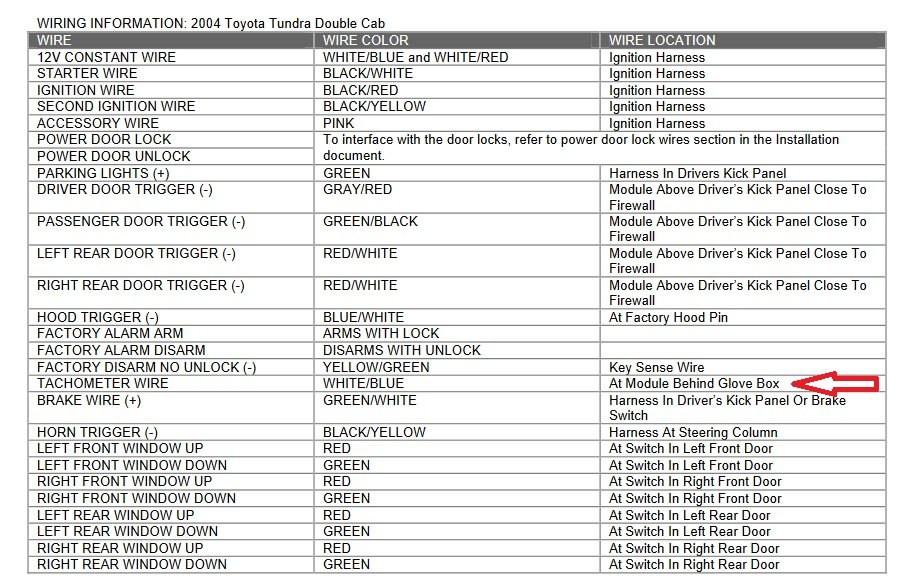

Hoping for some help finding correct wire to connect aftermarket tachometer

    Anyone here ever try to find the correct tach wire at the ecu ?

    From what I see it looks like blue/white is the winner. Welcome from CO!

    Right, that's what i thought until i put a meter on anything in that general area that could be construed blue/white with no luck. But just talking about it reminded me where the wire might be more easily accessed. I think they're all wired the same whether they have that option or not , so maybe its just hangin out behind the instrument cluster ?
