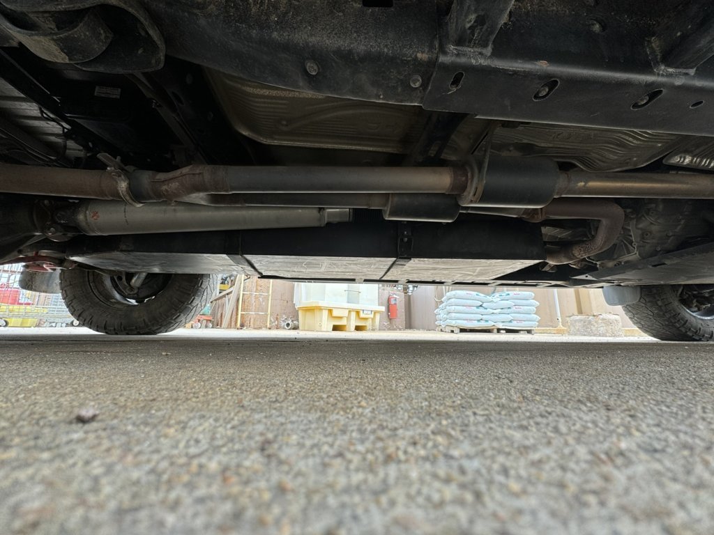

    I ran mine through multiple un-named trails in southern Utah in June, and we finished the trip in Moab including Hurrah Pass and Chicken Corners, I know I hit it a few times but it sits no lower than the factory tank. Plus it's steel as opposed to the plastic OEM so I'm not terribly worried about hitting it either.
    Nothing against you VTL, I just find it funny that the only people opposed to the 46 gallon tanks are the guys who bought trucks with 38's, and I do respect that. These just happen to be, IMO, the best option for those of us stuck with the 26g tanks from factory. It's a size and strength upgrade.

    Looks good to me, I am one of those stuck with 26 gal would like to upgrade but live in CA so I am not sure where to go for this...

    That's a nice photo, any issue with corrosion?
    I have 38gal and still want 46gal tank, jerry cans work, but I still hate it when the spill get onto the clothes and sitting in the car with gasoline smell is not my thing.

    None so far, besides what was there when I bought it. I got it second hand, there was one minor rock rash spot that had some surface rust.

    Yeah mine stuck down below the frame a little, but it was pretty stout. Their website says it’s made from 12 gauge steel. I know a skid plate is better than a direct hit on the tank, but it would take a pretty big hit to damage it.
