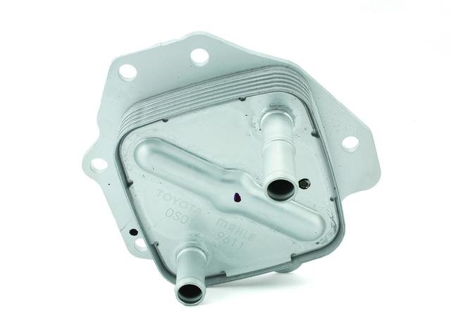

    The truck already has an engine oil cooler. They do make remote kits, but I had a SC on my 2010 for 50k+ miles and never thought I needed a separate oil cooler.

    mine is 2019, it seems to be integrated into the radiator, thus not as efficient as a stand alone.

    Hello, thanks. That does not look very effective. Better than nothing I guess.
    Anyone aware of a good direction to go for a better filter/cooler process? I am hoping to keep this for ever. Get it paid off, then maybe get a daily driver... Want it to go the distance.
