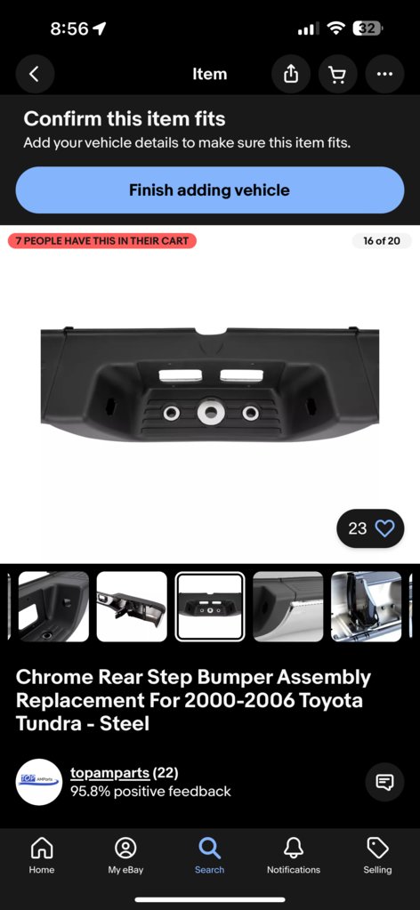

    Figured I'd check if anyone on here has a really good reason not to buy one of these before I do.
    I'm well aware Ebay parts usually aren't worth their weight in rust, but I've been keeping an eye out for used OEM's for a long time, and up here in the northeast they all seem to be in bad shape, overpriced, or frozen solid onto some parts truck in the middle of a field - sometimes all three.
    I expect the impact absorption would be worse/different from stock, but my current bumper is gonzo, nothing left at all, so anything seems like an improvement. I figure those cool welded setups some of the off-road guys run also aren't ideal for whatever crumple zones Toyota had in mind, so that shouldn't be a huge deal.
    Whenever I need to tow I use the frame hitch, so it's mostly cosmetic. The only real functionality I need is being able to step up on it without it falling apart.
    RockAuto also has one that's a fair bit more expensive from 'various manufacturers' that seems very likely to be from one of the same factories as the ones all over ebay.

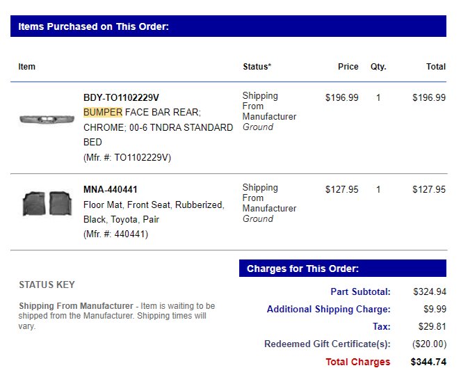

    This is the one I bought from Summit Racing: https://www.summitracing.com/parts/BDY-TO1102229V
    I paid $196.99, and they charged me $9.99 to ship because it's oversized (otherwise would've been free).
    I didn't need to enlarge any holes. Factory tow stuff bolted right up. All plastics snapped into place. Looks like the price has gone up since 2019, though. Hard to believe that was 5 years ago! Maybe you can find someone who has this brand cheaper. I think you can get OEM from Toyota in chrome cheaper than the current price at Summit with Coast to Coast.

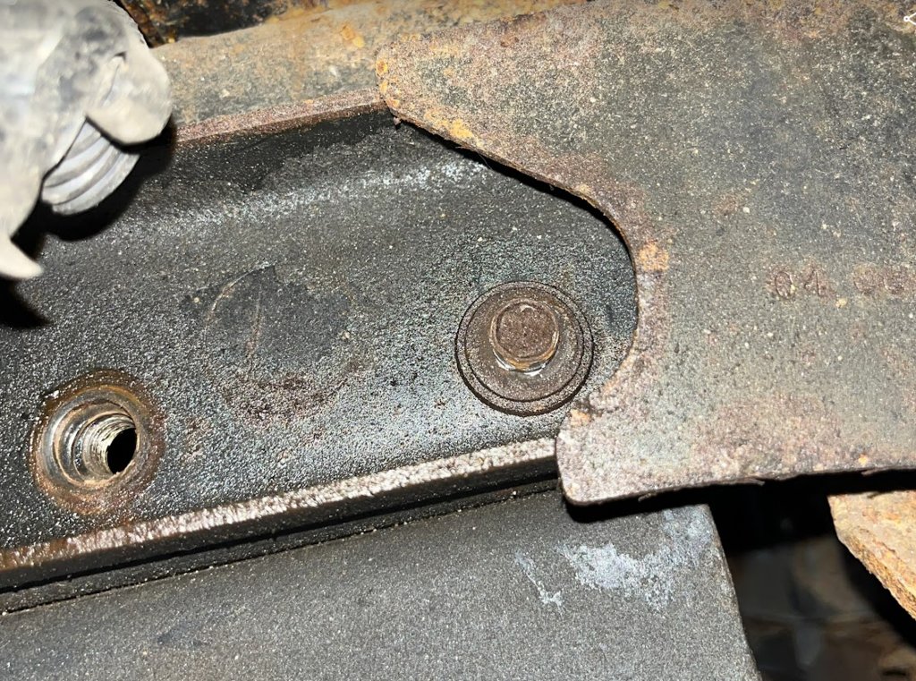

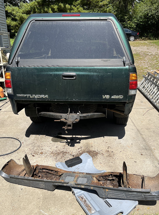

    Whelp.. as expected a few bolts came out and a few rounded right off. Specifically, one on each side where the brackets connect to the frame, and the two in front of the license plate which have a very shallow head. I even bought a can of Kroil for this lol :censored:
    I guess I'll pick up some of those hammer-on extractors and see where that gets me. I've heard a lot about going to muffler shops to get nuts welded on too, but never actually tried it. Not sure how common that is, but maybe worth some calling around. I wouldn't really argue about an hour of shop-rate for something like that.

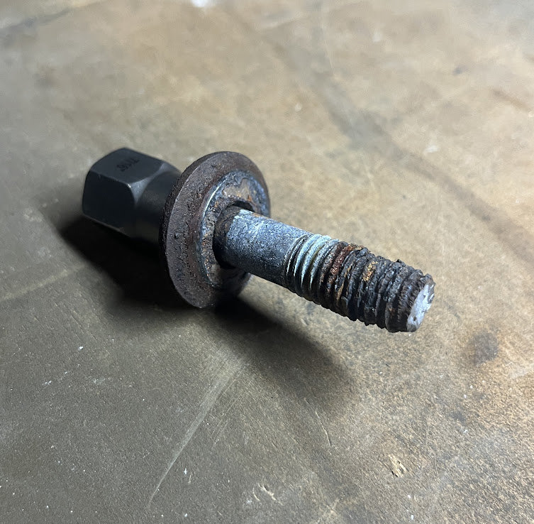

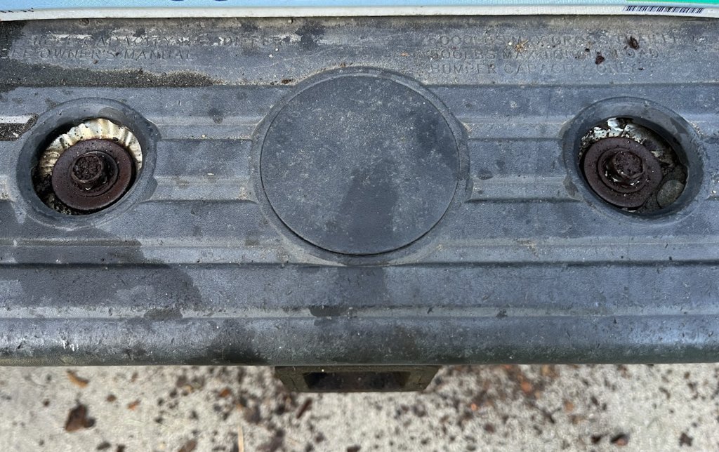

    Bolt biters worked well, so well, in fact that they got every bolt out except the last one on the step which got sheared right in half. Luckily I was then able to get the bumper off and had plenty of space to try every trick in the book for removing that stud. After an hour of drilling, chiseling, etc. I just cut the welded nut right off the bottom.
    Replaced both sides with some hardware store 10.9's (M12X70 + big ol fender washers), and that side got a new nut on the bottom which snugged up just fine.
    As far as the eBay kit itself, it was short a couple bolts for the side brackets, so I reused some that hadn't rounded. Also, like @Dook55 mentioned, the center plastic had a couple tabs broken off and was a bit floppy. The silicone is a good idea, and I agree for the price it was nothing too major.
    ^I thought the lowpro flange bolts were a bit of an odd choice from Toyota. Not to get too controversial, but I don't think shallow 12mm heads have any business on top of an M12 bolt lol. Granted it probably works fine 90% of the time when its not totally corroded out.

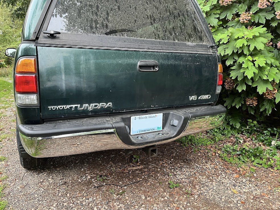

    Yep, I went with this original one I linked. Feels sturdy and overall I was pretty impressed with what showed up for the money. The plastics themselves were probably the lowest quality part of it. Mine came with a couple tabs broken off of the middle piece which makes it not lock in place perfectly, but it wasn't worth a return for me. Otherwise, there are some very slight stamping creases around the edges of the chrome which might not be there on OEM but I'm not sure.
    Paying more for just the faceplate from somewhere like Summit might get you better results if the rest of your assembly is good, but I expect most of the eBay full assemblies in this price range are of pretty similar quality.
