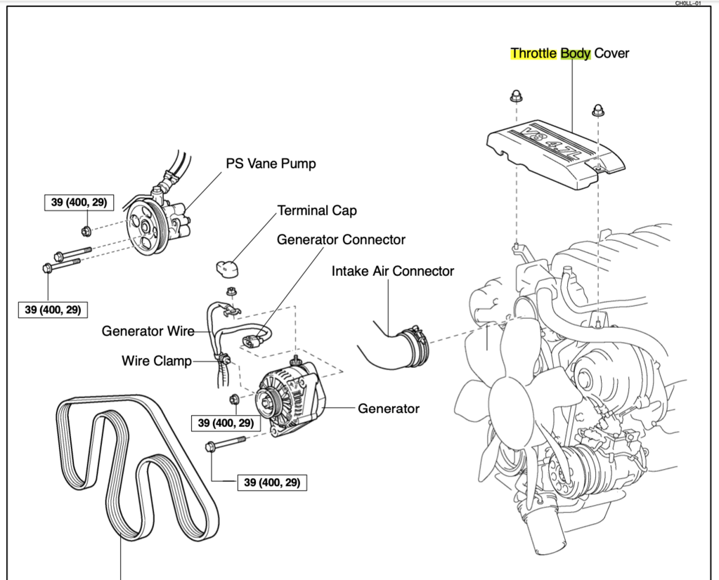

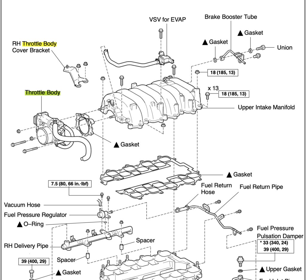

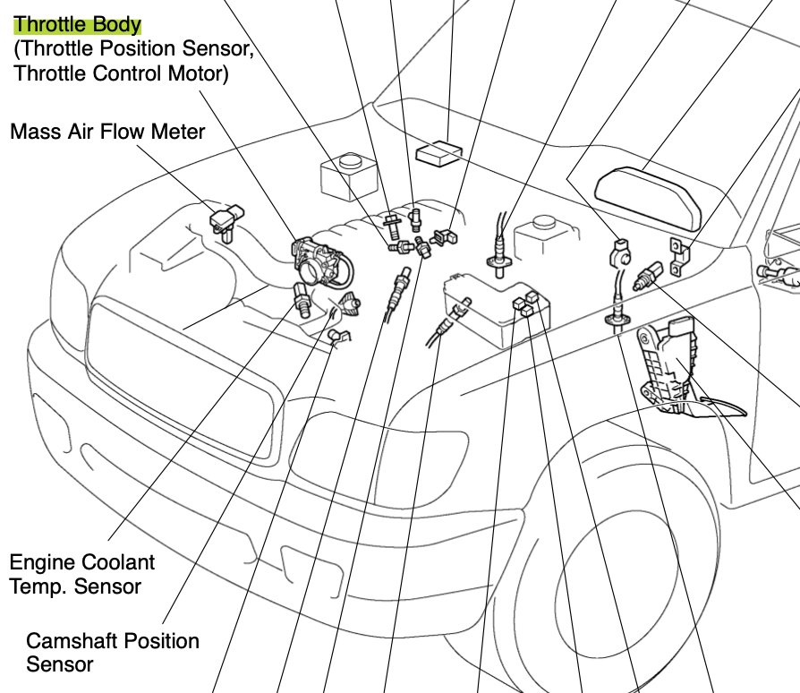

    Here is a diagram. You'll remove the hose from the air box to the throttle body and inside you'll see the butterfly. It'll be obvious once you see it.

    Easier if you remove it but it has two coolant lines and a couple electrical connectors that may break. Gasket may need replacement if it’s been on a long time. You can do it with TB on vehicle remove plastic intake duct. Hold throttle blade open with your hand or plastic utensil ( don’t use metal object and don’t let it snap closed. Spray TB cleaner on a rag and rub the blade and the aluminum bore clean. It will take a little bit of elbow grease. There are some good YouTube videos. When finished remove negative battery terminal for a few minutes to force ECM relearn. You will have to re-do your radio presets and clock time

    Do it on the vehicle. No need to create more work.
