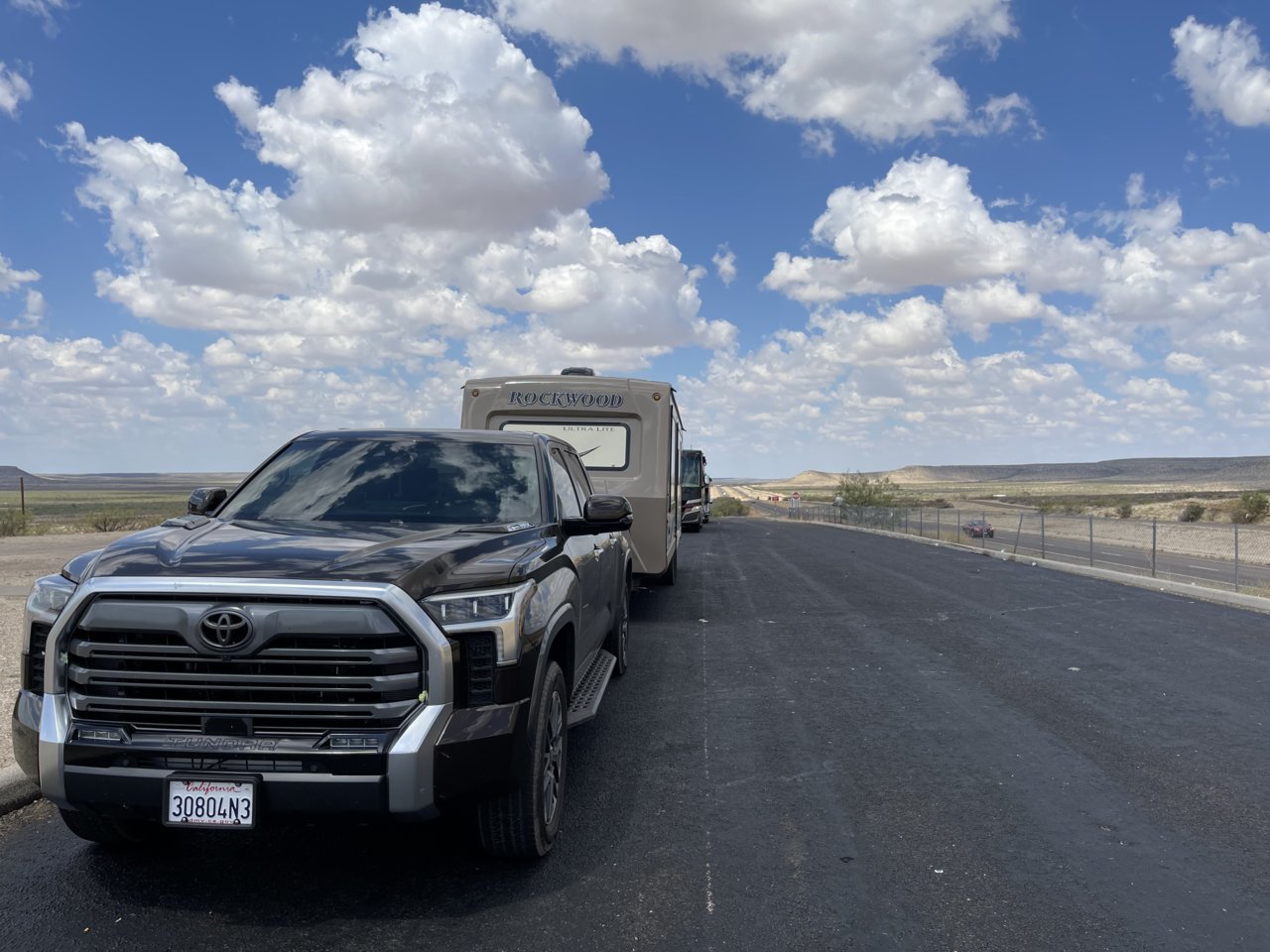

    I’m almost done with my trip LA to New Orleans, 1.5k miles so far.

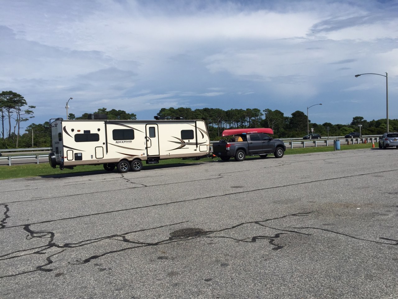

    I had a 2013 Rock Worrior crew maxed and we did lots of towing with it.
    Now hybrid crewmax 4x4.
    Ride and power is not even on the same league, I forget that I have the trailer behind many times.
    Now my problem is MPG. Same trailer
    Just different trucks and I’m getting the same if not wore mpg with the hybrid that I did with the 5.7. I try 87, 89 and 91; It’s about 0.5 mpg some times 1 mpg better with 89 or 91, the engine felt way better on 89/91. Speed 65-70 mph most of the time and I’m averaging 8.5 mpg sometimes it goes up to 9.

    I think that's a wire cutter ;)
