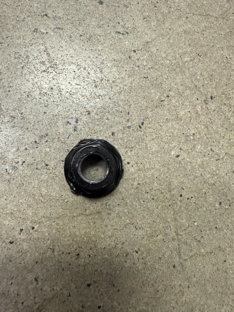

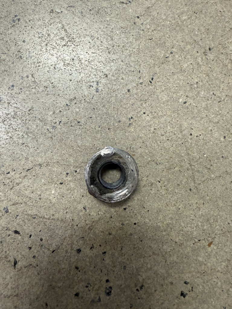

    So here is the outcome from the nut that was welded inside the frame. Welded in three sections. All fixed now thankfully.

    So I’m guessing they welded in a new nut in the hole. And what was the cost of the fix?

    there is an access hole on the side of the frame above where the sway bar is. It is large enough and no drilling was needed on the frame to remove. It cost me a total of $300. I would say better than having to total out the truck like one user did…
