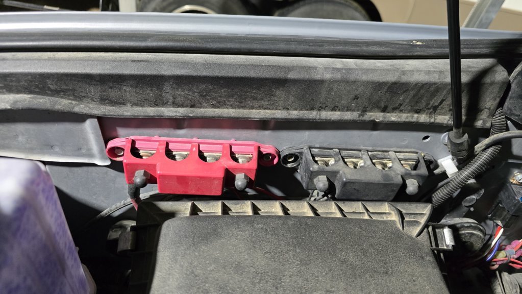

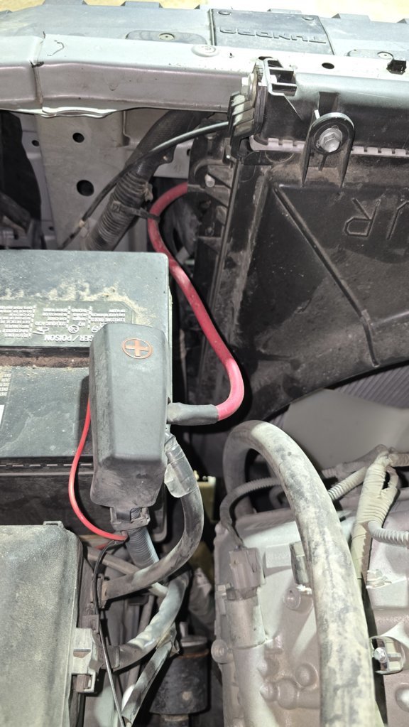

    I installed power bars on the right side under the hood. From there I ran a relay with a switch by the Tow Haul switch. I'll search for pics and send if you want.

    Yeah that would be awesome. Honestly anything would help since this will kinda be like my first mod to the truck

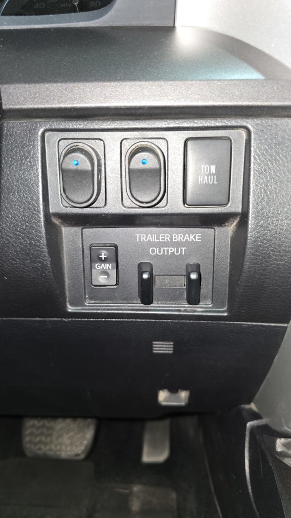

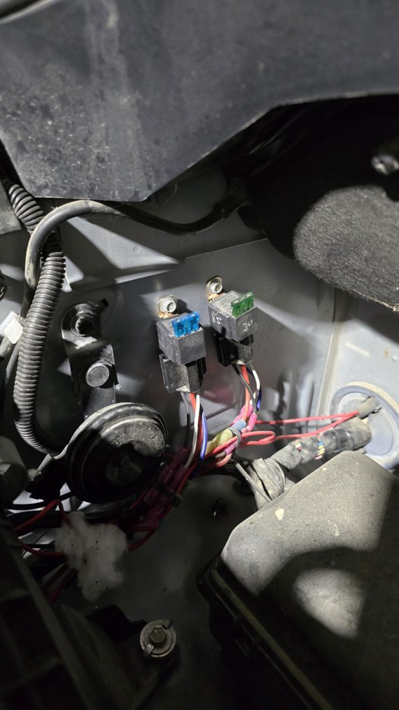

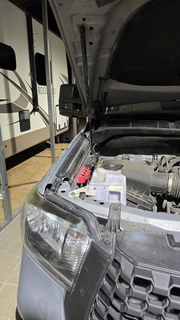

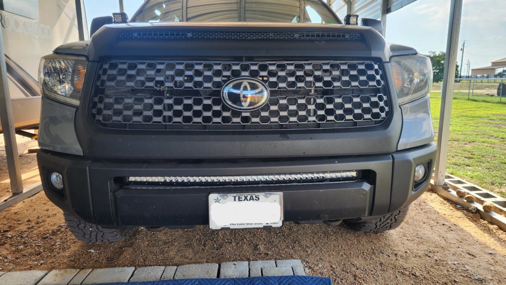

  30. Oct 8, 2024 at 4:26 AM
    #30
    icodeintx
    icodeintx New Member
    Feb 16, 2022
    #74719
    273
    Scott
    Palacios, Texas
    2021 Cement Gray Tundra SR5 CrewMax
    LED Headlights, LED Fog Lights, LED Interior lights
    Here are the photos. Wow didn't realize how dirty my engine bay was. Guess I know my weekend project.
    First you see the two switches I put near the Tow Haul switch. There are actually some aftermarket switches that match the Tundra switches but to me they feel cheap. So instead I added a different cheap switch. I like these switches. Next I added the terminal blocks under the hood on the right side. From the battery I routed a red cable which is made to length. The negative cable is mounted under the black terminal block to a grounding point which was already on the truck.
    Behind the terminal blocks I used relays to power the lightbars. You DON'T want to wire your lightbar to the switch directly. The lights use too many amps and most switches will just get hot and melt. That becomes a serious fire hazard. Instead get some relays. These are cheap on Amazon. There are also a million videos on YouTube on how to wire these in. Note: First I decided on wiring the relay using the Negative Trigger method. I didn't like it because the LED on the switch wouldn't work, PLUS if there is ever a fault in the switch or wiring then your lightbar defaults to the ON position. I didn't want that either, so I'd suggest wiring to a positive trigger like a normal switch.
    What you don't see in the photos is the wiring harness for the lightbar itself. I used the harness that came with the light and just cut the end off to wire to the relay. It is routed under the terminal blocks and down to the bumper where the bar is located.
    I'm very happy with this setup. The bar is extremely bright, and it is low giving me perfect light on the road where I want it.
