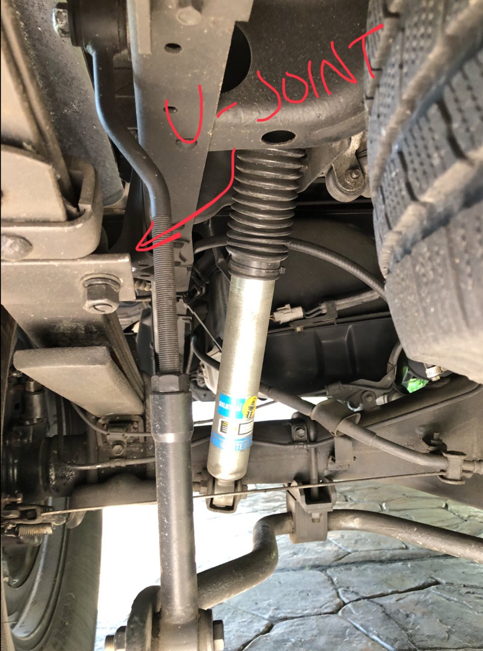

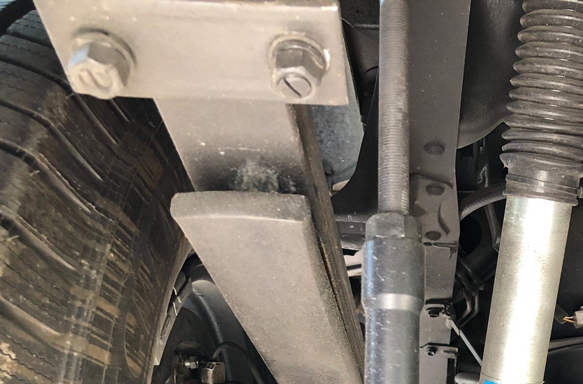

    Any advice for straightening out rear leaf springs on my 02’? Drivers side was slightly splayed/fanned (1/4”) out for years. Passenger side slightly less also. Now with my new 5100’s on all 4 corners, starting to notice a side slippy feel during cornering going up on inclines.
    Went under and seems the driver side has splayed abit more than it was an additional 1/4” more (now at 1/2”).
    I want to put on some leaf u-bolts to secure the leafs (existing oem clips are slightly bent open allowing the situation), but need advice on getting these things straightened/squared up first so the new u-bolts supports can slide on.

    Figured it out on my own. Made my own vise out of hardened steel leafs and thru bolts as c-clamps won’t fit propper. Sinched the leafs back in alignment by torquing the bolts a little at a time. Getter dun!

    Best pictures I have which aren’t the best angles.
