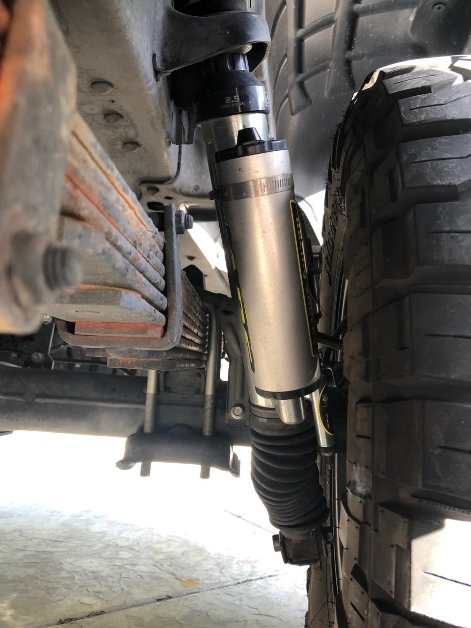

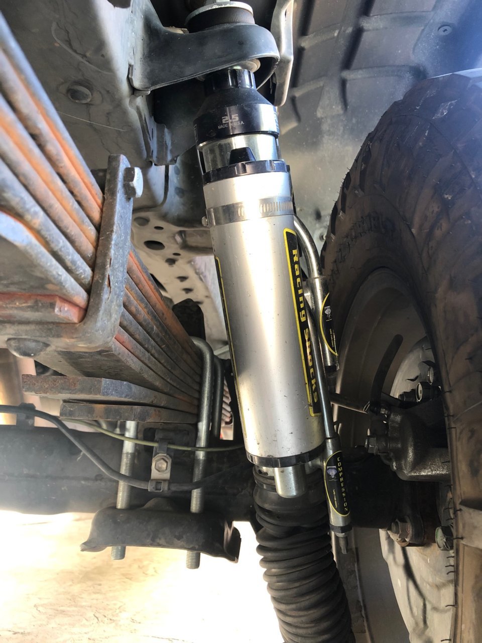

    Big random ask, but hoping someone can help me out here. Can anyone with ads bypass (or any bypass for that matter) crawl under the back of their truck and snap a photo for me? Looking for a photo being shot from where the rear diff. pumpkin is; outwards towards the rear shock/wheel but trying to get the full shock body in the photo if possible (I know the leaf will cut some of it off and that’s fine). Passenger side would be better because the shock is exposed more. Thanks in advance!

    Here ya go:
    Passenger-
    Driver-
    Mater[QUOTED] and 831Tun like this.

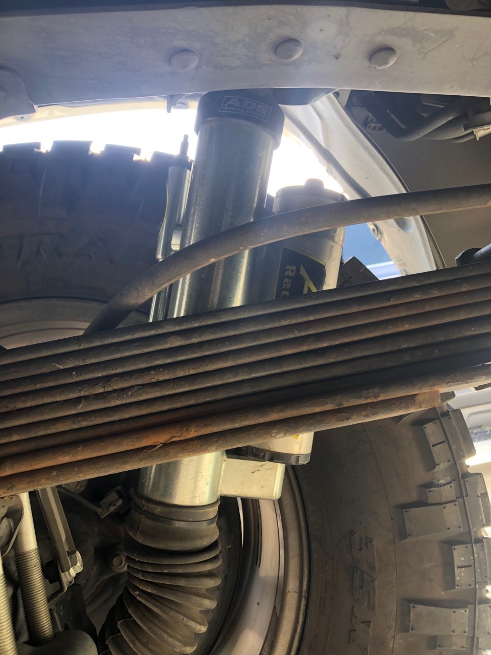

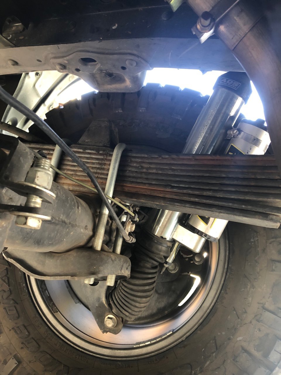

    I have them with rock warrior wheels and 315/70/17s. They are VERY close but don’t rub.

    Some people stated they rub on articulating bump, have you verified no contact when cycling the suspension?

    I’ve cycled it as far as in can go in an articulation type scenario (bump stop contact if I recall) and they “barely” clear. About 3/8” of inch if I remember correctly.

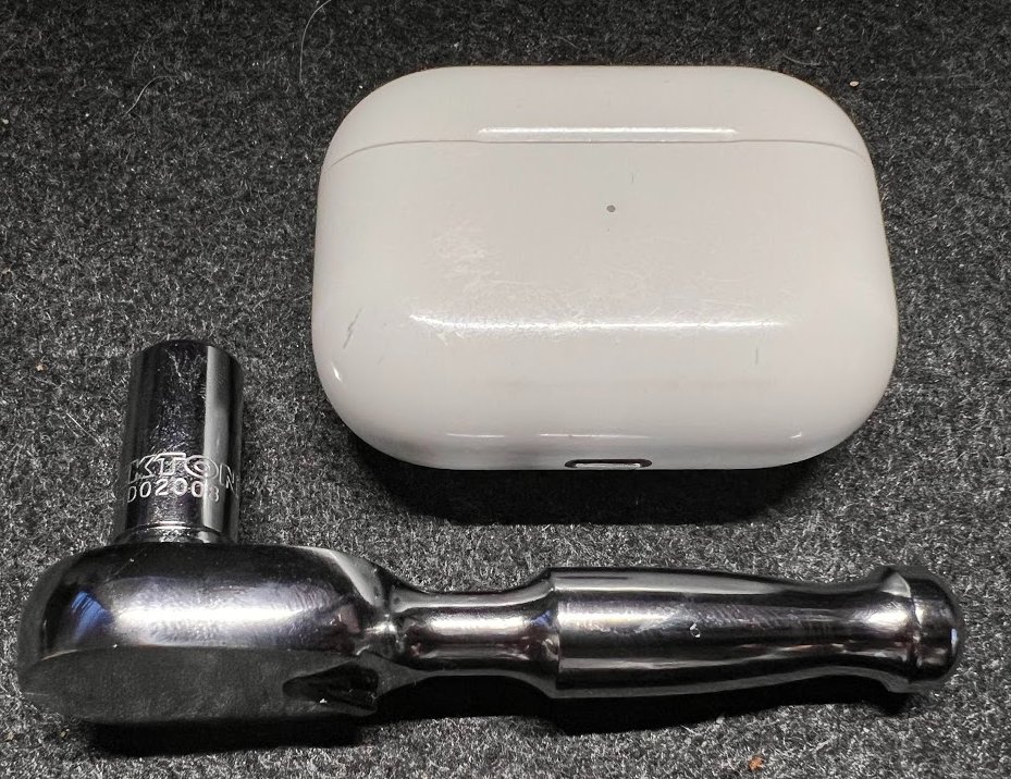

    Some external bypass shocks have options for finger clickers...
    For Fox...
    Fox has QAB and needs to be upgraded on a discharged shock.
    or requisite 6 point socket and stubby ratchet and leave it in your glovebox with your wheel key...
