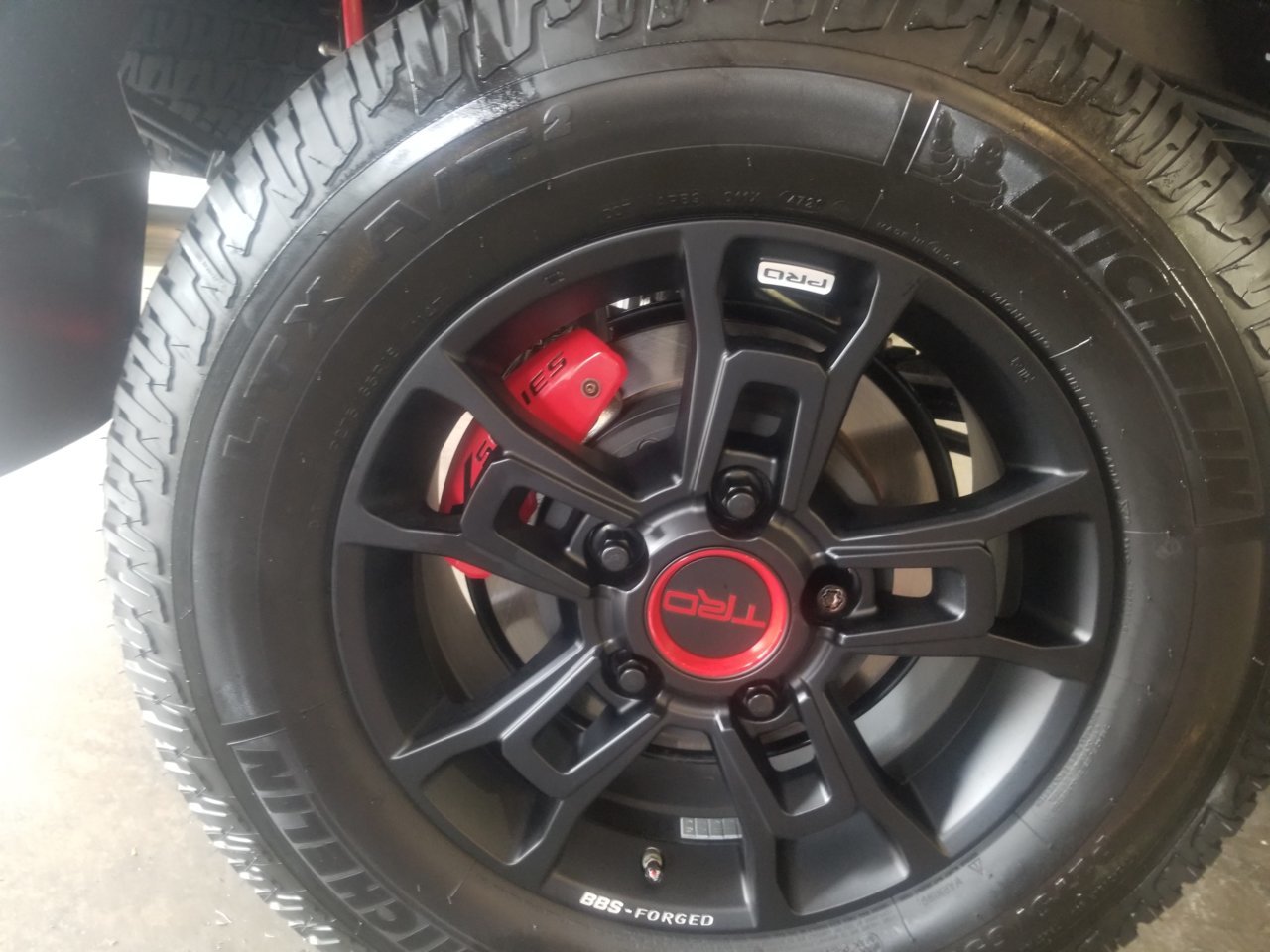

    Wanted to add the caliper covers to my new TRD Pro and the ones offered by Toyota are blah at best and will not fit the 18"BBS fronts. Only choice is painting them or aftermarket with spacers.
    Don't want spacers so I painted the fronts and have some black TRD stickers on the way. The rears look like ass painted IMHO. So what to do?
    The MGP's covers are cheesy looking to me and overpriced, but I like the Toyota covers on my wife's 2019 Camry. Long story but I had two of those leftover from her car so I worked out how to mount them on the rears of my truck.

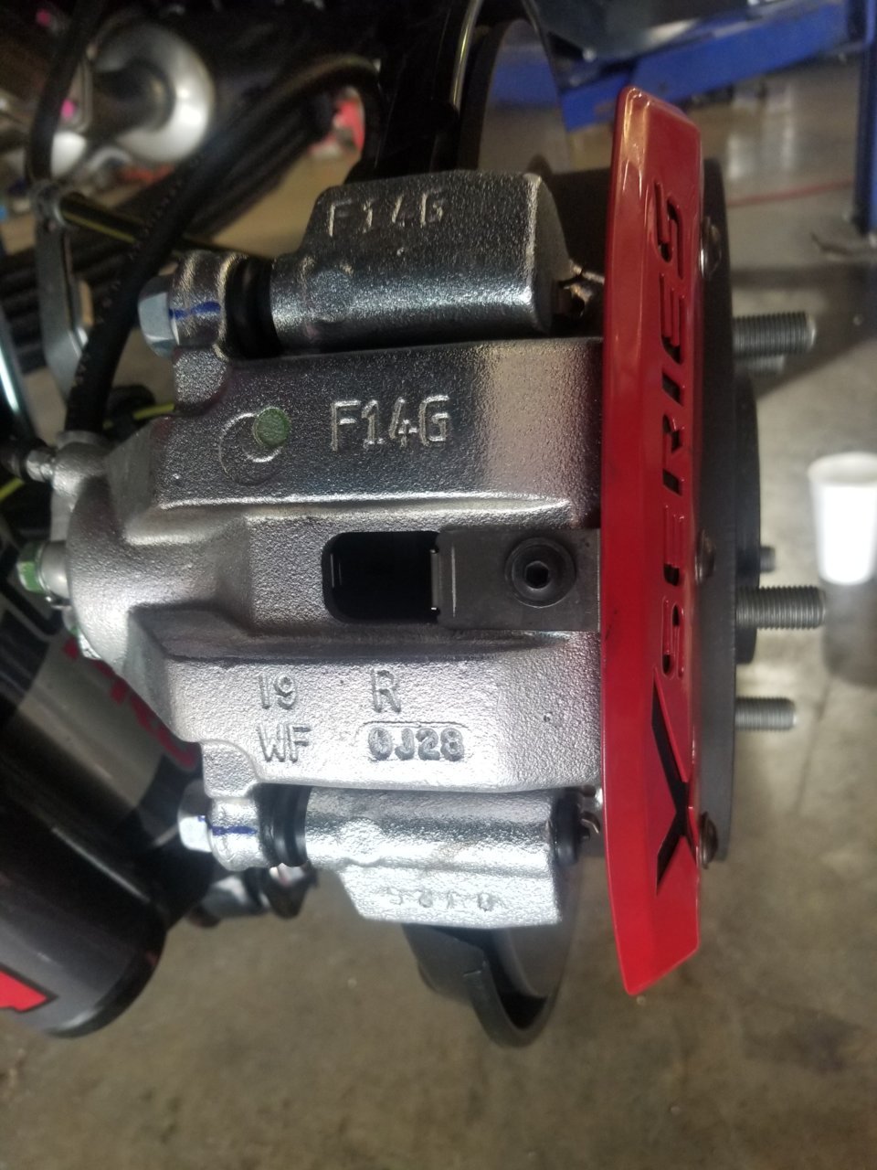

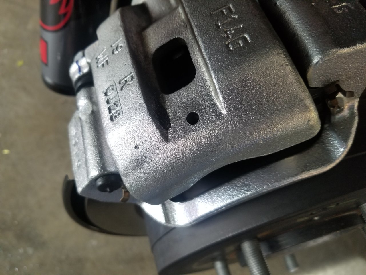

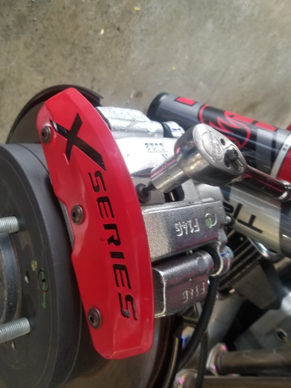

    First I drilled and tapped the calipers for one of the 1/4-20 pan head bolts from the kit, drilled the upper mount on the Camry covers and bolted them on. Nice and secure and I like the look. Still need to pull the back off and black out the exposed part of the caliper.
    Camry Cover set of 4 from Toyota is 140.00. Use two sell the others.
