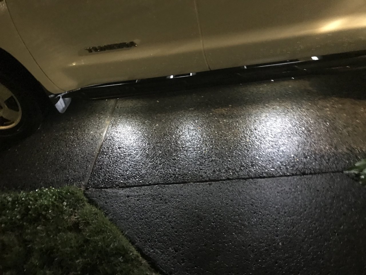

    A few... Definitely more than 2
    Not a 1st gen so yell at me all you want (there is a 1st gen in the first picture if that makes it any better :notsure:). I stuck some led strips to my frame rail and routed wiring up through a rubber grommet into the cab.

    @Tundra2, that’s a clean setup, I hadn’t considered the led strips :monocle:.that’s a way better throw of light than the factory door lights
    @APalmTree, no hate here man:thumbsup:, I like that placement on the frame. You wire them in to come on with the keyless entry?

    That's the running joke on all the 1st gen threads :rofl:
    Currently, I have them wired up to the cargo light circuit so it comes on when I press the unlock button or when the doors are opened. At some point, I plan to switch it over to the courtesy light circuit by the e-brake.

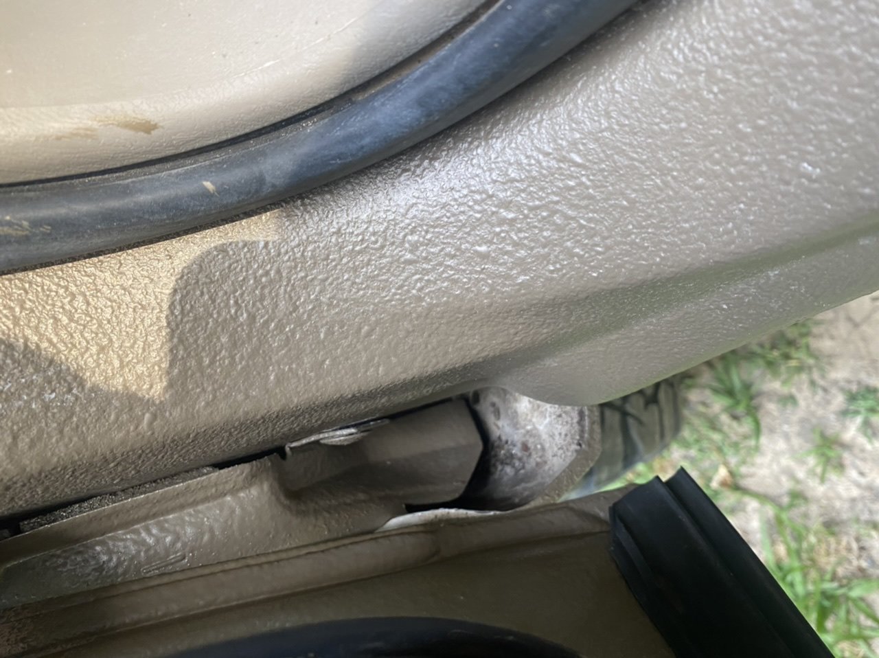

    I’m curious about the relay. Original game plan was to mount in the bottom of the mirrors. I was gonna drill the base that attaches to the door since the bottom is flat. What I didn’t account for was the stud that the mirror itself rotates on.
    *here’s the lights I was gonna use. I’m second guessing they maybe too big.

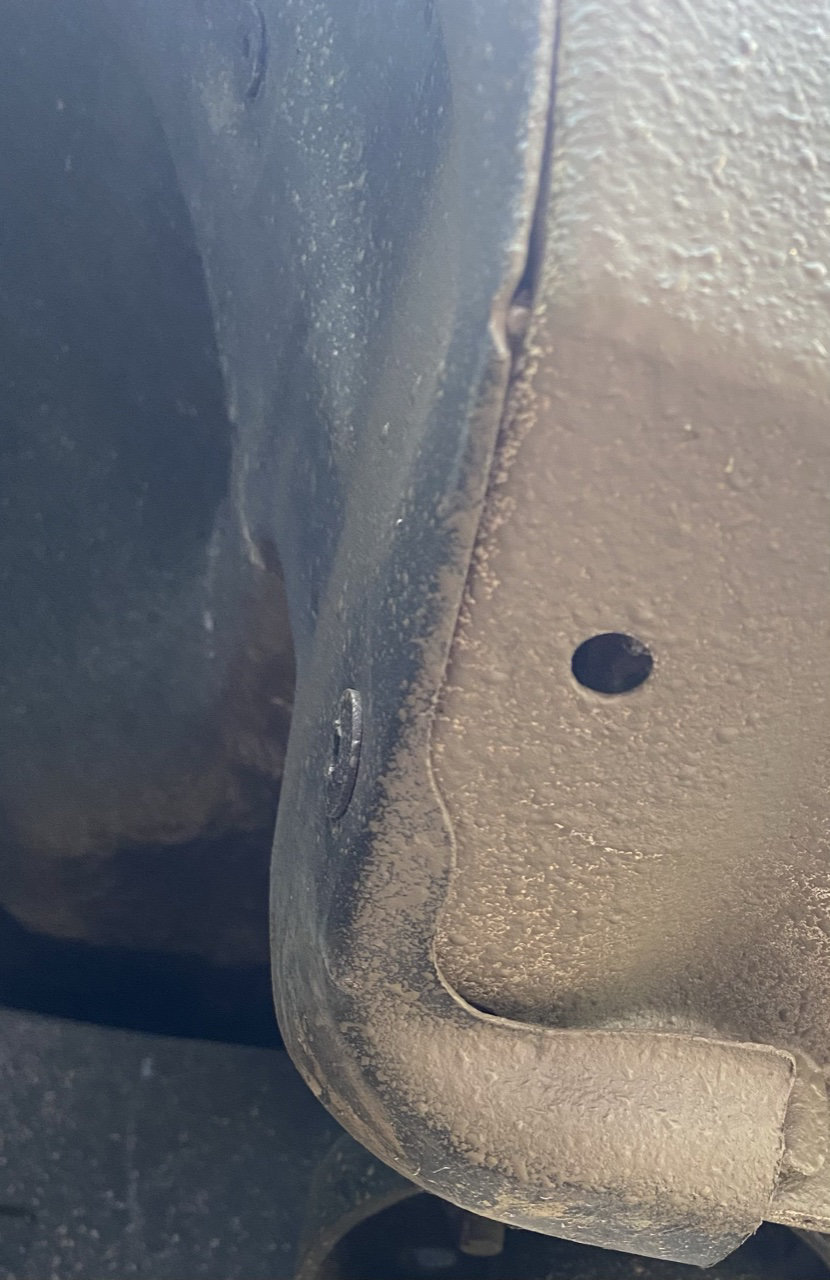

    Next placement idea, the mudflaps were removed for paint, which left this hole in the bottom of the fender.figure this will kill 2 birds with one stone. Seals ups the hole and I get puddle lights lol
    When I was brainstorming this idea, I was gonna run into the cab and add a pigtail fuse in the fuse panel. Except I now know the fuse for the dome light circuit is under the hood.would be pretty ease to run up the inner fender and into the engine bay
    thoughts on placement?

    I had to really look at that second photo because it's rotated 90° to figure out what it was. Inside drivers side door jamb by hinge?
    That would be doable if you think it would provide enough light there. I recommend taping that light to the fender with clear tape, and touching the leads off to a drill battery or something so you can get an idea of the light out put before committing fully.

    @Tundra2
    Spot on about drivers side door jamb
    Idk what’s up with that door jamb picture, I rotated it every way you can trying to get it right side up. When it uploads it rotates, right on the phone though.
    * good call on the drill battery idea. Might’ve saved me a screw up. Appreciate it :thumbsup:

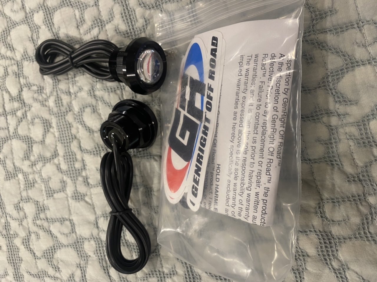

    here’s the advertised specs on the lights:
    • 10 watt LED produces 800 Lumens!
    • Stud mount, 1-1/4" threaded housing (as pictured)
    • Ultra bright White LED.
    • Machined aluminum housing is black anodized.
    • Impact resistant construction.
    • Fully sealed, corrosion and waterproof.
    • Draws only 200 milli-amps each at 12 volts.
    • Weighs just over 4 ounce each.
  11. May 24, 2021 at 5:41 PM

    Lights came from GenRight off-road. Hopefully they’re as impressive as the specs seem to be lol. I’m hoping the throw will be pretty wide since they’re marketed as a rock light

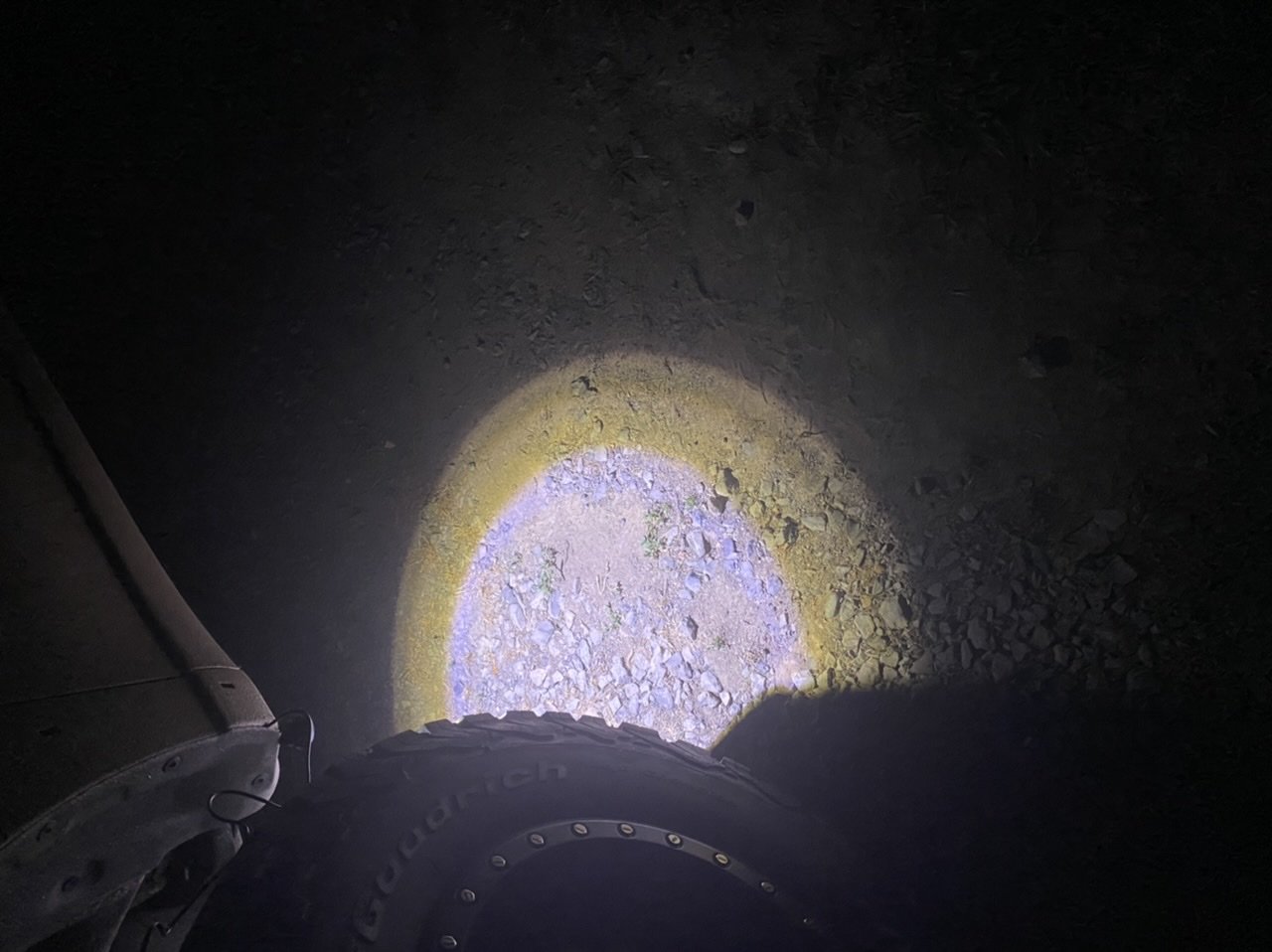

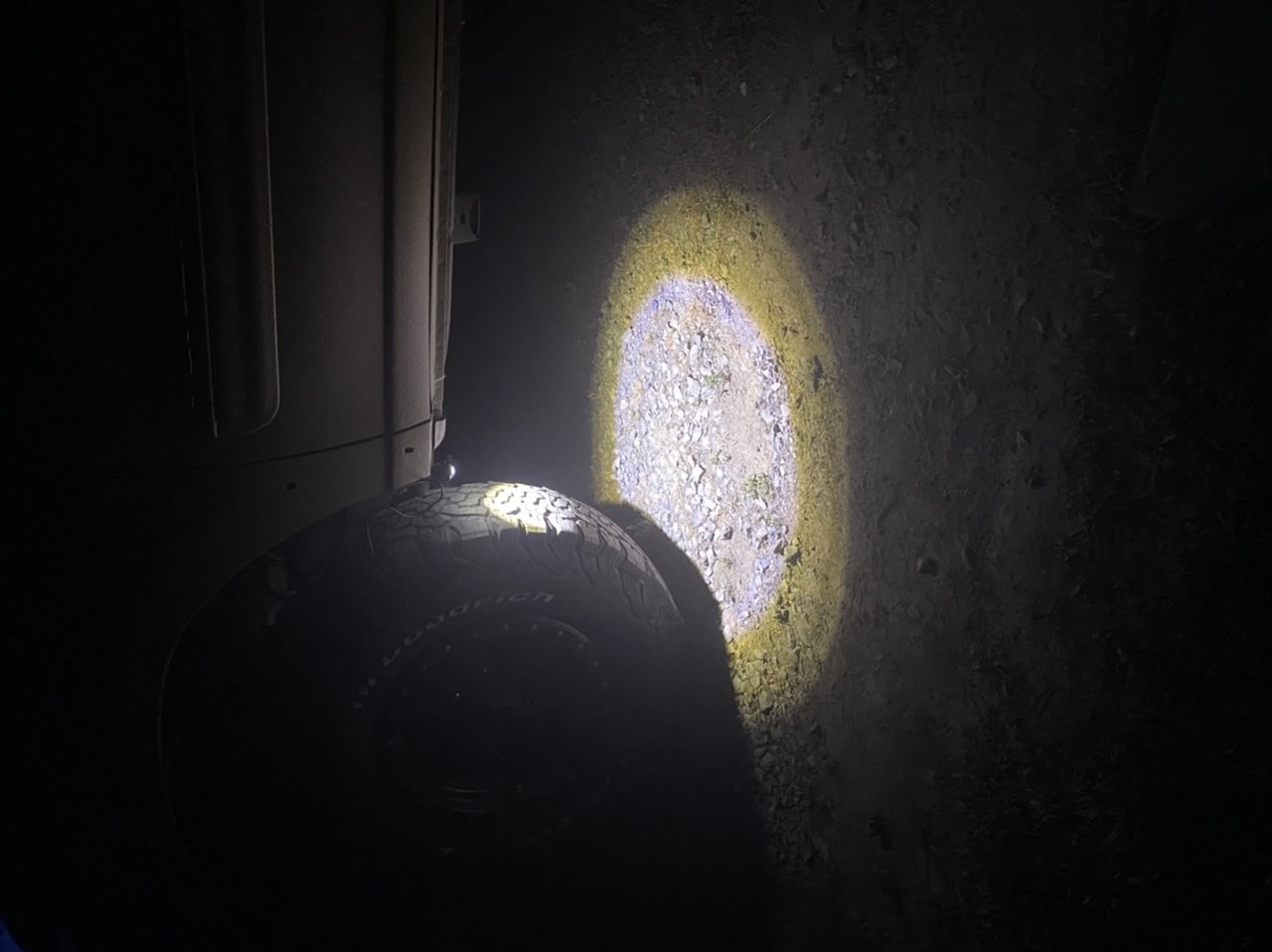

    @Tundra2, good news I got to test the lights out and they’re bright as hell. I buy them again. Bad news I don’t know that I like the placement of them in the fenders. The more or less are acting like rock lights there. The throw would be so much better in the mirrors.
    3FC40BB1-2C32-4E08-B4F9-E1D5948BB616.jpg 91D82917-E2B4-4F0E-9CFA-E6E73757FAF7.jpg
    I’m not sure why it keeps rotating my pictures either.
    how hard is it to Pop the lenses part of the mirror out?

    Hmmm need to find a light that’s more of a flood pattern rather than the circle of light. That would help way more

    Yeah, those lights look great overall, but wrong location. Mirror might be more acceptable. I would happily redo my door strip lights underneath. Zero Complaints.

    @Baller that’s more along the lines of what I was trying to accomplish. That looks good
    @empty_lord, I meant to get a picture of em under the mirror. They covered a lot of ground right there.
