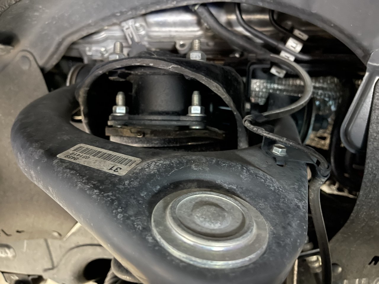

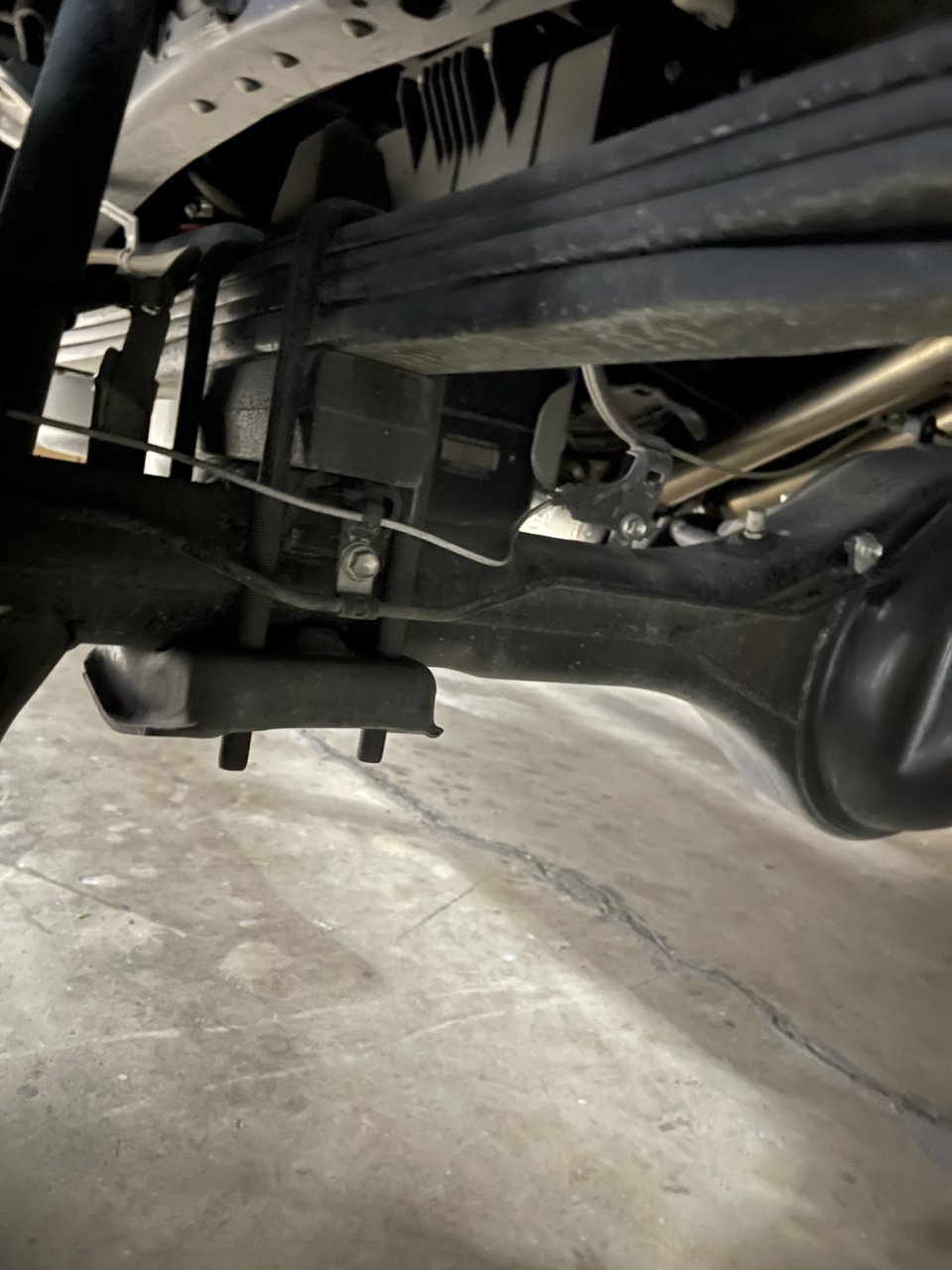

    Post pics of the current spacers and blocks that you have. A 3/2 shouldn't have the front sitting 2 inches lower that the rear.

    F393BA4D-D528-4F86-9D52-33F9C848F143.jpg 5231865D-7B35-4EEF-98D7-0450707CEFD8.jpg

    It's appears to be installed correctly. I'm still trying to think of why you would be so low in the front.

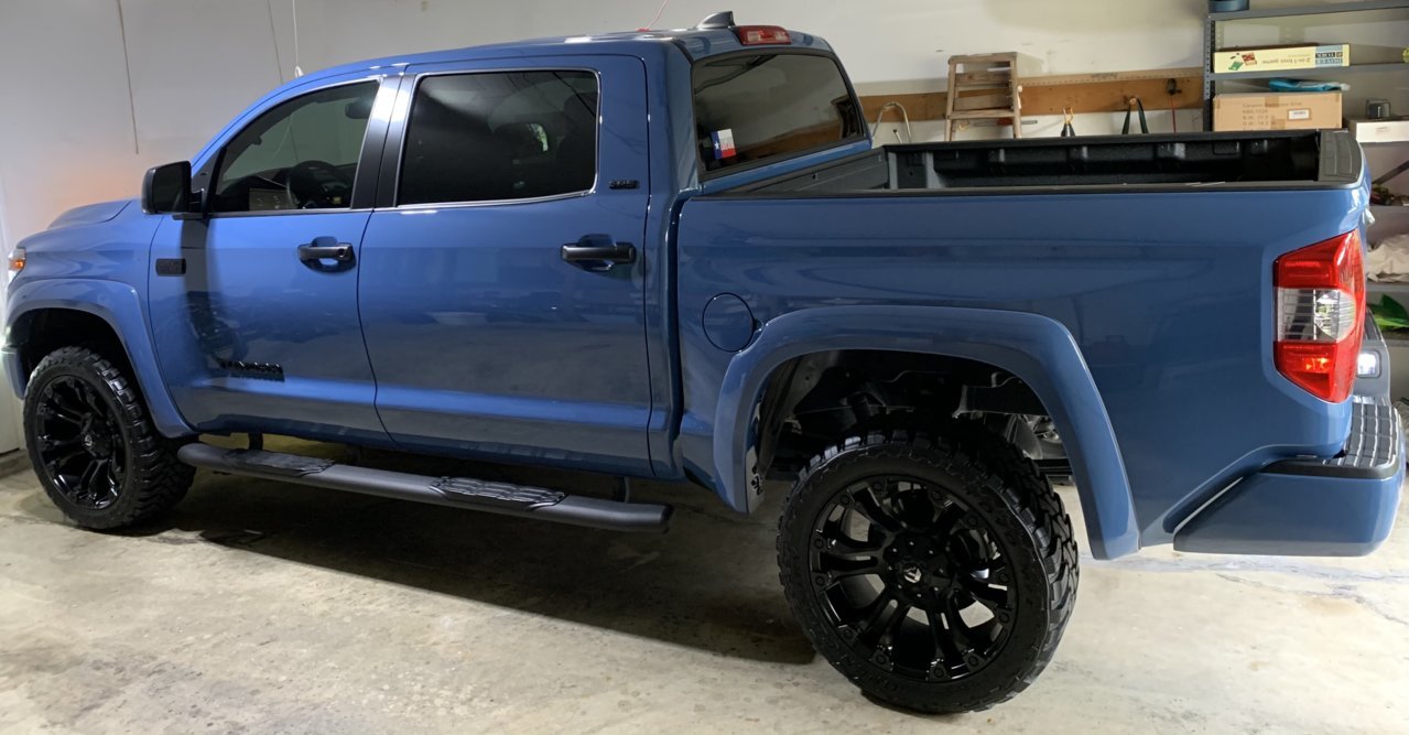

    Post a side view of the whole truck.

    Doesn't a 3/2 still leave some rake. It certainly won't be level. Even a 3/1 still has some rake. I swear I've read people putting 6112 on the top setting with nothing in the back just to level their truck and isn't that just under 3 inches. I could be wrong.

    My 2013 with the 3/2 was dead level. Every truck sits differently.

    I actually like the rake I think they look better like that personally. But like I said easiest thing you can do is go down to 1” in the rear.
