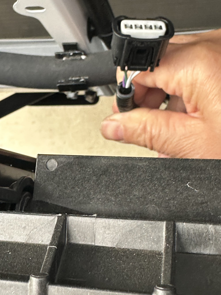

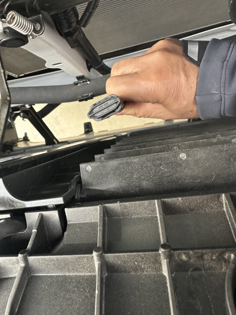

    I think I found the wiring nicely taped and covered by Toyota. Need to figure out if I need an additional wiring harness that splits to each light.

    I removed the front bumper cover and found that you will not need any wire harness, the fog light wires are ready for you to install the lights. Some say you don’t even need to remove the bumper cover, but it’s actually fairly easy, It takes 10-15 minutes.
