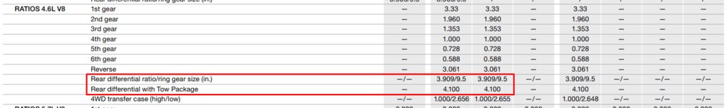

    I think I might have read it wrong regarding having more tow capacity with factory installed tow package. In the process, I've found a very helpful pdf for the truck specs https://cdn.dealereprocess.org/cdn/brochures/toyota/2014-tundra.pdf

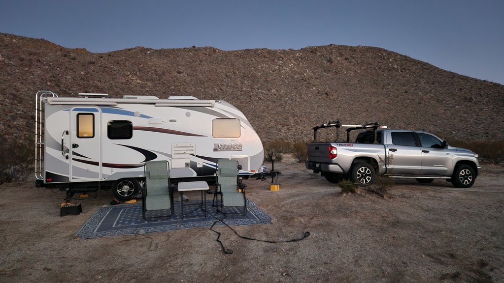

    Wow, I thought my pets were spoiled, yours get their own bedroom?! :rofl: Oh crap, I just realized our cats have their own room.
    Be advised, if you're getting that 672 lb. tongue weight from the web or brochure on that trailer, you need to know that manufacturer's "published" tongue weights are dry weights before anything is added to the trailer, and notoriously optimistic.
    Whatever the actual total weight of the trailer, you need a BARE minimum 10% of that to be tongue weight. Could be as much as 15%.
    So if it's loaded to 7,000 lbs. (Lbs. add up FAST) and you have 12.5% (middle of the range) of that as tongue weight that's 875 lbs. plus your weight distribution hitch (many of which weigh 80-100 lbs.) you're bumping 1K lbs. and your pets aren't even in the truck yet.
    Just as an example, the "advertised" tongue weight of my little Lance is 405 lbs.
    When loaded to go camping it's usually between 700-750 lbs.
    I do travel with a full fresh water tank, but I've also shaved a lot of weight by switching from conventional to Lithium batteries, and my Andersen WDH is lighter than most.
    I don't say this to be disparaging, but I get the feeling you may not have a lot of towing experience yet? Which is absolutely okay, we're all new at some point, but the last thing you want as a newbie is too much trailer trying to push you around.
    Don't let my comments discourage you from your dreams, just do your research before pulling the trigger, and try to be realistic in your abilities, your trucks abilities, and your true needs.
    Tow for enough miles and someone WILL cut you off and then hit their brakes. They don't know Jack about the 3 tons you're hitched to and they don't care... They just don't wanna' miss their exit.
    I've had a few scary moments while towing: stalled car in my lane on the freeway, debris in my lane, mattress, semi tire carcass, a microburst of crosswind outta' nowhere that wiggled us violently.
    I've been able to stop, avoid, &/or ride out every scary situation so far by staying calm (when deep inside I just wanted my Mommy) and because my truck/trailer are well match and well within limits.
    I feel like some or all of those could've had a real ugly outcome if I'd been towing a 35' trailer.
    Be safe and enjoy, the trailer is our happy place.

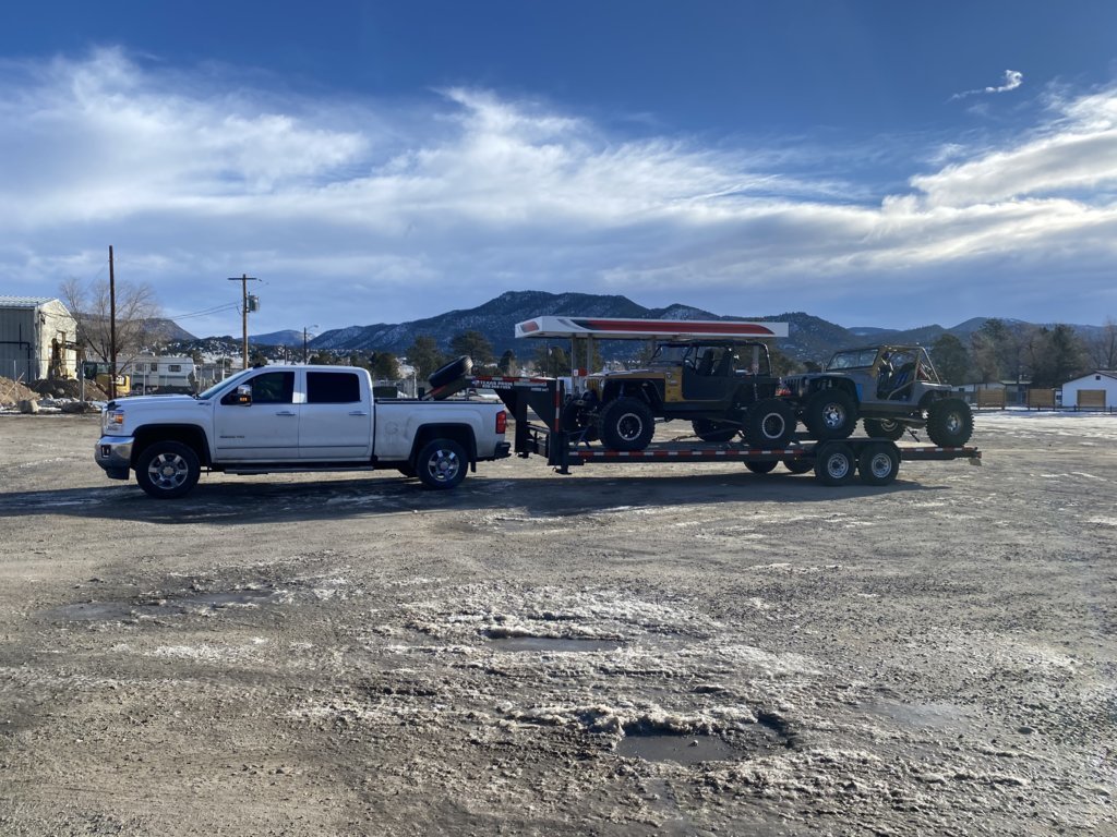

    I personally would not buy that trailer. If you do, hopefully a different truck.
    I personally would not tow that trailer with my 1 ton Duramax diesel. 30' is the cutoff and moving to a gooseneck/5th wheel setup.
    My truck will pull it with ease, but not as easy as a 5th wheel.
    Not sure how much you have towed in CO, but we see armature hour all summer long here with vacationing drivers towing huge campers that are underpowered due to elevation. You can lose up to 34% of your max power in Colorado.
    This is 28' of trailer behind my truck...and you want to attempt another 7'.
