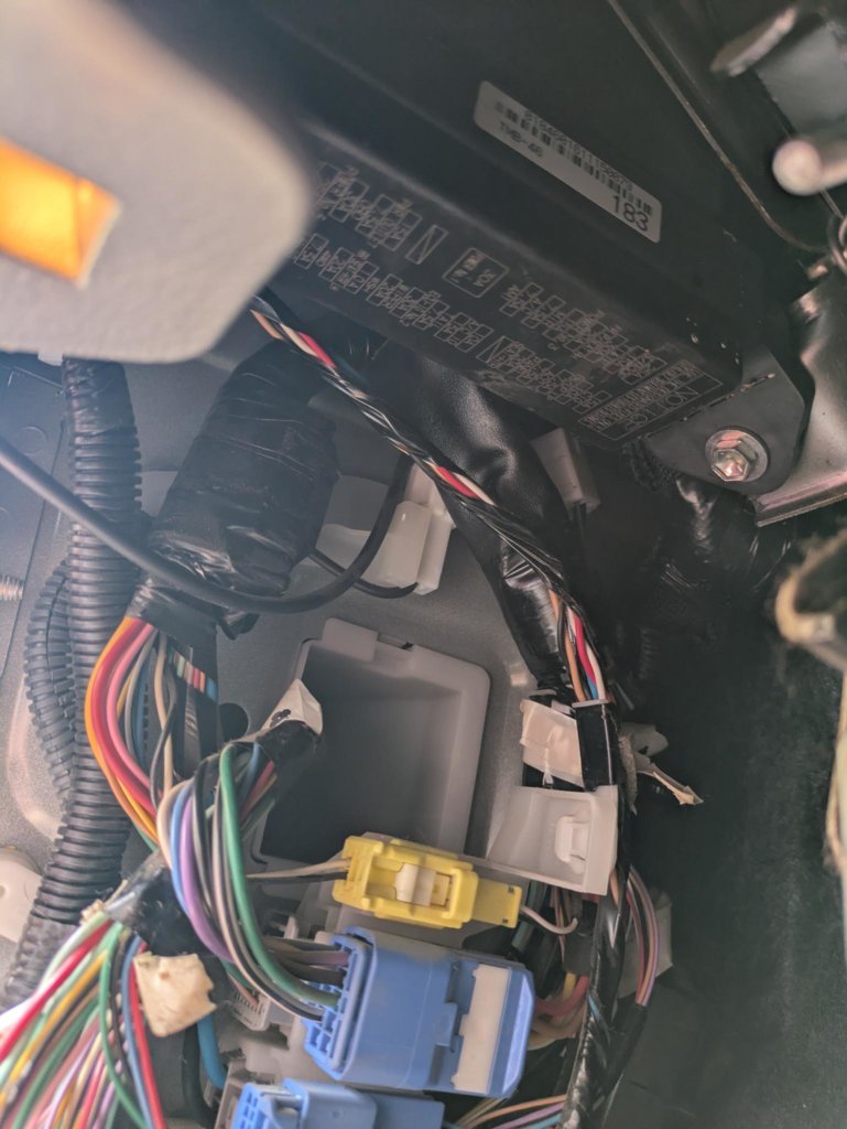

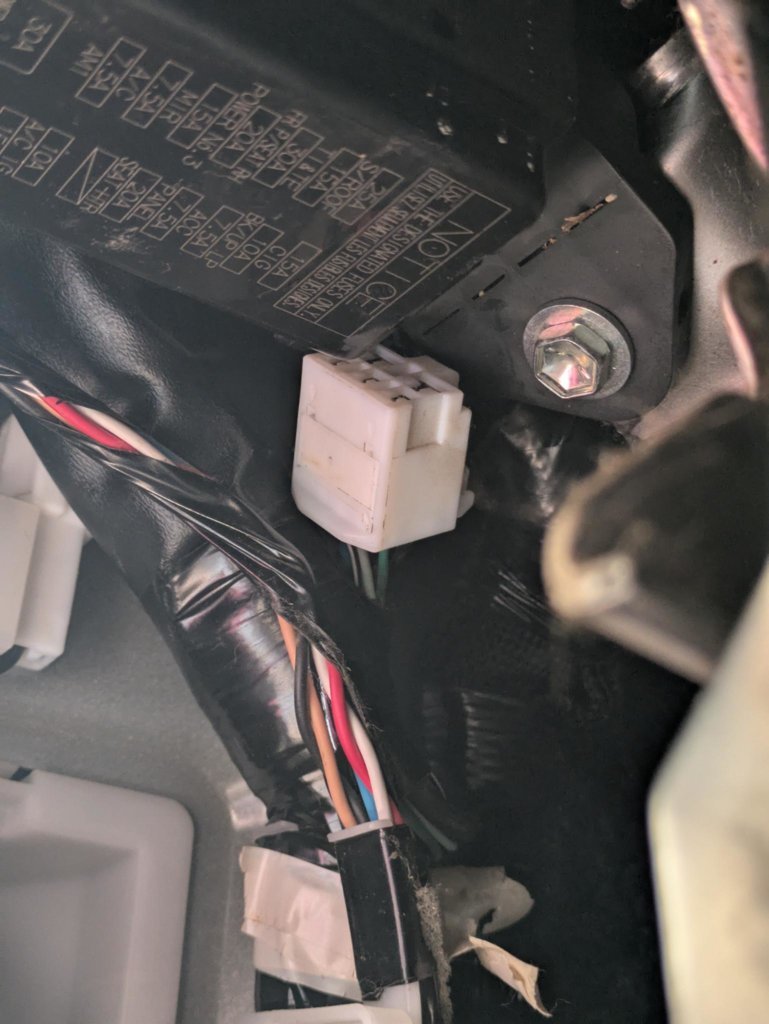

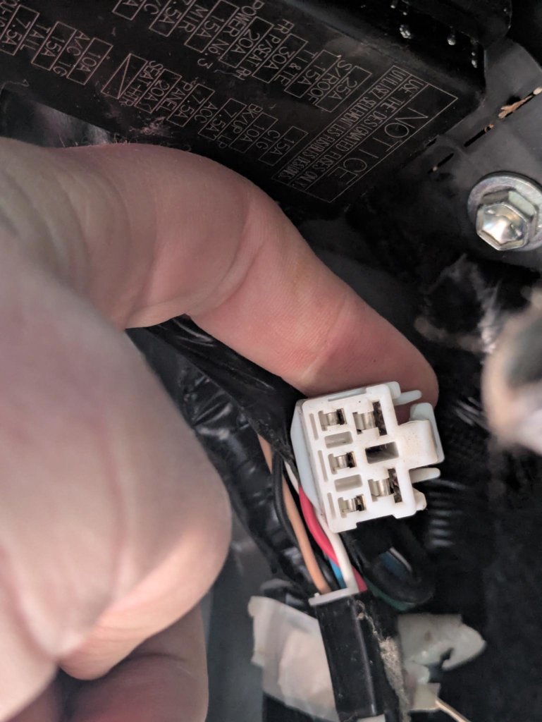

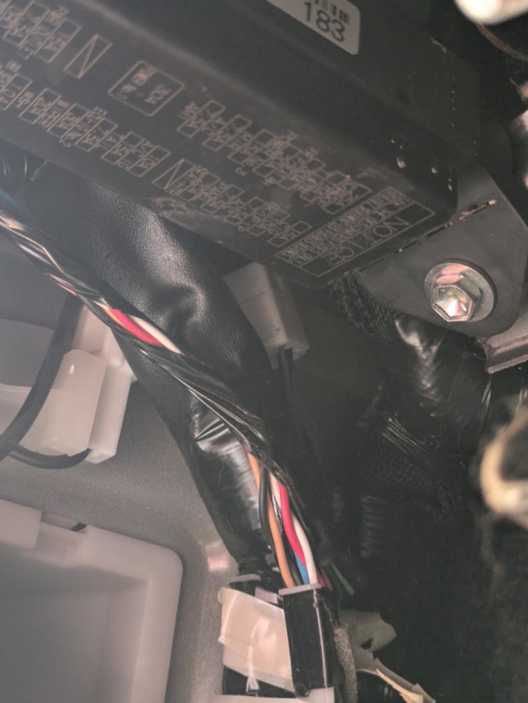

  11. Mar 15, 2025 at 10:13 AM
    adro
    adro New Member
    Mar 15, 2025
    #131926
    It took a bit to find mine on my 2017 Sequoia. It was very high up and mostly hidden, but closer to the door frame than I expected. Here are some pics. In the zoomed out pic, you can see it hiding in the shadows toward the top of and behind the other wires.
