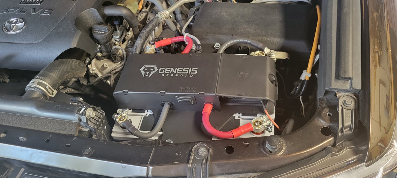

    This is really all you get for instructions and reference to Genesis website for YouTube videos for Tundra installations. Here are more pics upload_2023-6-7_10-39-58.jpg the end result of MY installation.

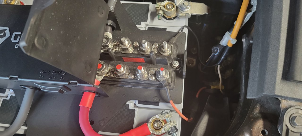

    This is the connection terminal. I will connect my winch cables to the largest posts on the left and as you can see, my frig is wired to those on the right.

    I must add one caveat. My Tundra is 2018 w/LED headlights that require moving the fuse box 3/4" toward the ABS solenoids because of the larger backing of these headlights in particular. Genesis includes the necessary hardware should you be in the same year of 1794 editions. All the hardware is excellent quality and includes a few extra nuts and bolts.
