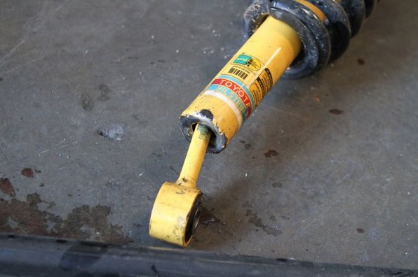

    That tall of a spacer lift will ride kinda harsh. screen-shot-2018-01-31-at-7-16-32-am_orig.jpg
    This can also happen if they are compressed too much.

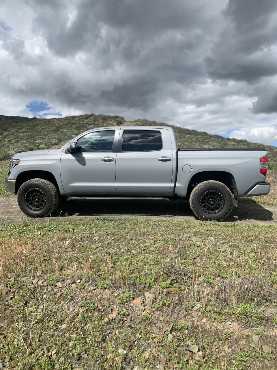

    Here is my Tundra for reference. 3/1.5 on 295/70/18. I had slight rubbing on the front finder liner but nothing a little heat gun couldn’t take care of. I think with a 3.5 lift the 295/70/18 would look too small. 35/12.5 would be the way to go. @Toytec Lifts shackles have both a 1 and 1.5 inch setting.

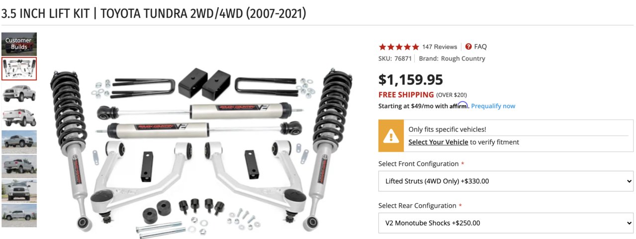

    Feel free to ask away @jetso . That’s what we are all here for. Are the Rough Country coilovers adjustable?

    @TwistedTad - thank you sir. Great question, I don't think so. Here is a picture of the actual config I got.

    They do not appear to be adjustable. Again, I think the 295’s might look a little small on a 3.5 lift. I believe some tire companies make a 35/11.5. Either way I’m sure you are going to like the look of your truck. Again, please feel free to ask away!!!

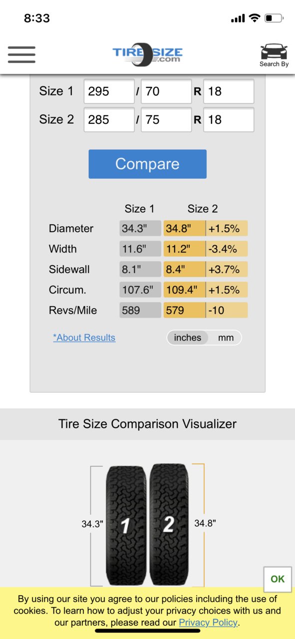

    Here is a tire size comparison of a 295/70/18 and a 285/75/18. The 285/75/18 is slightly taller and slightly narrower which would help on the factory rims. I’m no tire expert but hopefully more people will chime in.
