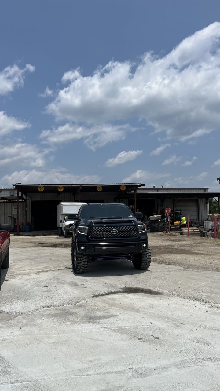

    I have a 6in rc lift kit that i wanted to add 2in spacer lift to the front wondering if anyone else has done this3F2DBA12-3F74-4C46-8930-00DC5D713E6F.jpg

    DO NOT stack lift components.

    I'm with Tunra234. I think you'll cause yourself way bigger problems in the future.
    If you want more lift on top of the RC, add a body lift. That might not be your preference but it is the only other lift that should go with a suspension lift IMO. If that is not an option, go with a custom complete redo to get the desired height you're looking for.
