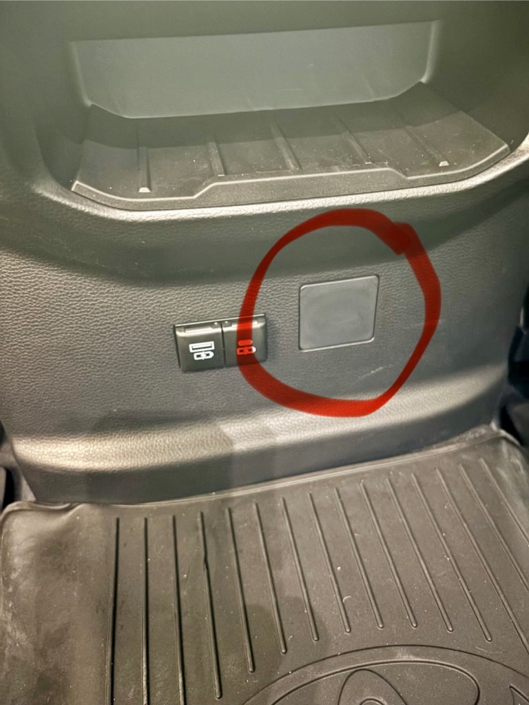

    I have a 2025 SR5 with the dual USB power ports for the rear seat passengers, but no inverter plug.
    I removed the back panel apart and the 12vt/inverter plug has a blank fitted, and it has a pre wired plug in wire that just needs to be plugged in.
    I am looking at finding out what i need to install a regular Cigarette lighter port (the same one on the top of my dash).
    Has anyone done this and what part/or what is the easiest plug n play kind of thing that needs to be done.
    Thank you in advance.

    Yes Sir, the back panel just pops out. Remove the rear cup holder piece by pulling up, that exposes the rear vent panel. Pull backwards and you will see the wiring harness and plugs. The blank i had for the factory inverter has a plug and is prewired. I chose to run wiring from the battery ,through the fire wall, under the dash and along the center console. ( i easily tucked away the wiring). Ran the wire straight back to the inverter plug blank, drilled a hole in the blank, and wired up/installed the a cigarette lighter style plug for my 12vt connections.
    I already have a portable inverter that I can now plug into the cigarette light and also have several items that i can plug in from the back instead of draping an extention from the top of the dash. I wanted a simple install to give me options. I will try and post pics later.
