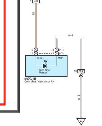

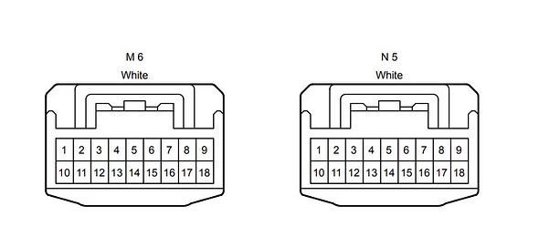

    If not, here are the BSM wire colors on the mirror plugs, you could either pull the pin from the connector or simply cut it.
    I would test the wires with a DMM and make sure that the pin in the plug is indeed the one causing the BSM light to stay on before cutting it..
    Wire colors are the same for 2015 or 2020.
    N5 and M6 are your mirror plugs in the door.
    It should be pin 18.
