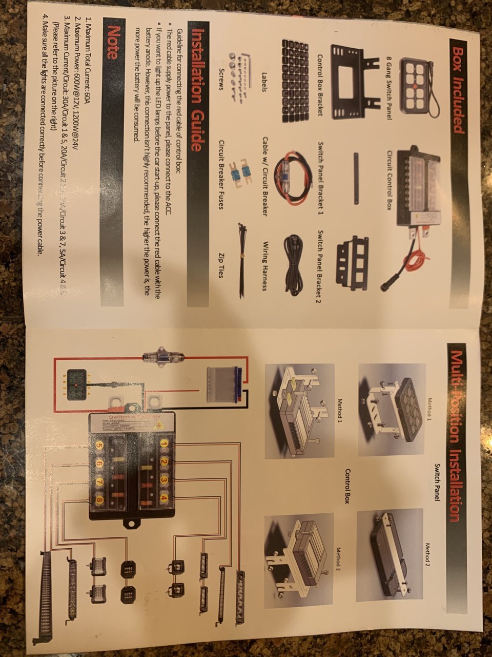

    Help please. I’m wiring in my auxbeam switch panel and I’m not sure which fuse under the hood fuse box I should put on the add a fuse. I am also confused if I need to up the amp of the fuse I am adding it to. I don’t want the back lights on the switch panel to be on when the ignition is off so it needs to be added to something that needs to be off when the ignition is off.

    Usually ignition

    I take that’s the 10 amp fuse marked ign. Do I need to up the amp to 15 or 20 amps on that fuse?

    Nope just put the 10amp ignition fuse on the bottom and your new fuse on top.
