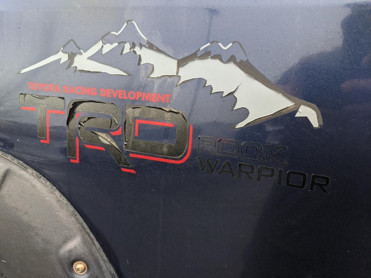

    Most true TRD stickers are all one piece, like on an Off Road or Sport. Not saying that the Rock Warriors are one piece but looking at my TRD OR and others, they are one piece. My point is, that yours could be a sticker that someone made and stuck on the truck to give the appearance of a higher trimmed out truck. I assume you bought it used like that, if you didn't and you bought it new, then disregard my comments. LOL.

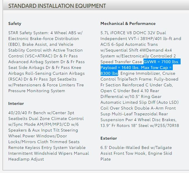

    So my is GVWR = 7100 lbs, Payload = 1640 lbs, Max Tow Cap = 8300 lbs, Curb = 5460 lbs.
    Am I correct in assuming that GVWR (7100 lbs) - Curb (5460 lbs) - Full tank of gas (~146 lbs) - Passengers & cargo (600 lbs) = Max Hitch Weight Capacity (~894 lbs)?
    If so, would I be good to pull a travel trailer that has a Hitch Weight of 785 lbs & Dry Weight + full fresh water tank of 55 gal. (456 lbs. + 6835 lbs = 7291 lbs)? The trailer has a Cargo Weight of 2750 lbs.

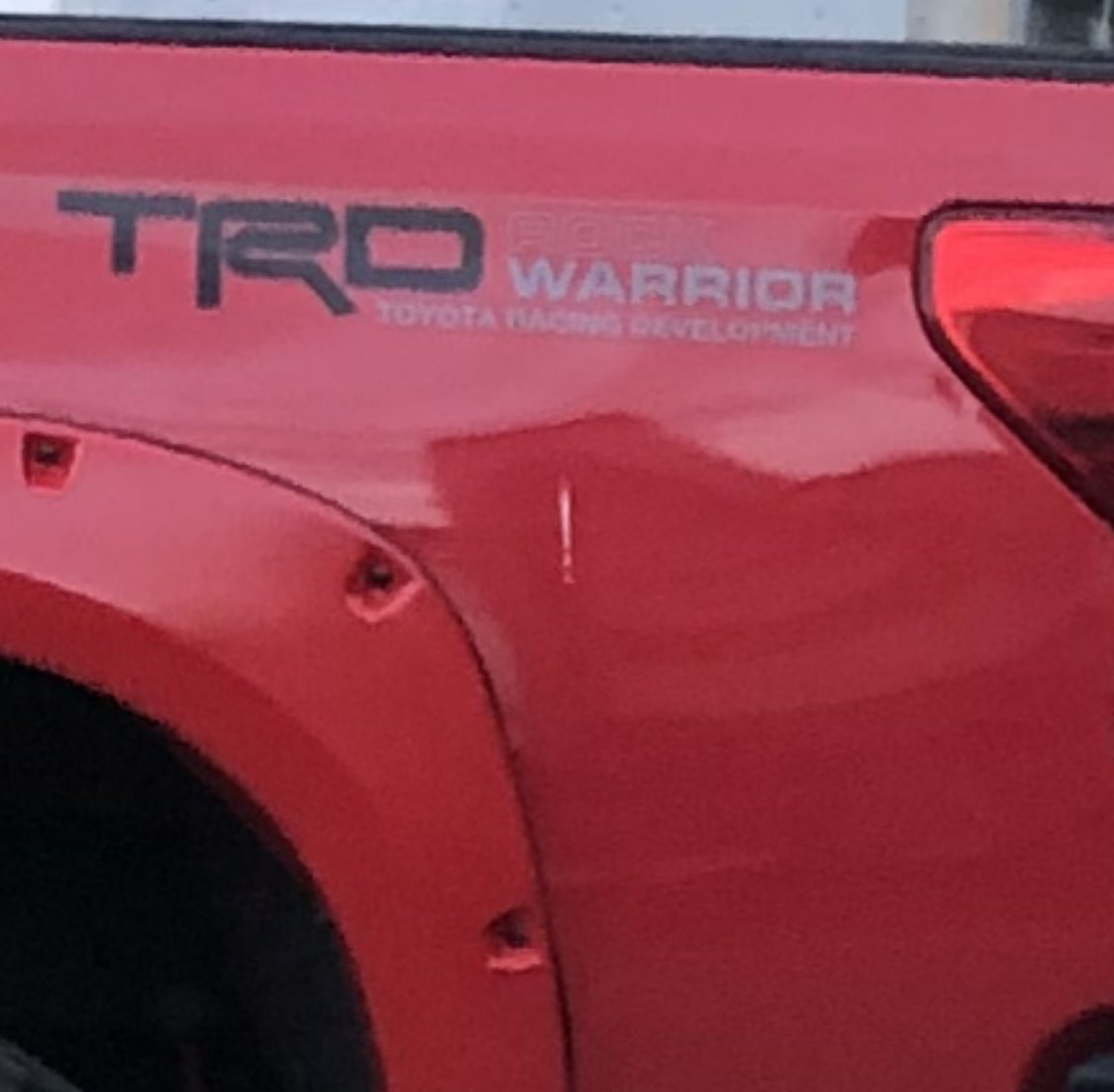

    That is not a OEM Rock Warrior decal. Also Rock Warriors came iView recent photos.jpg n Red, White, Black and Gray

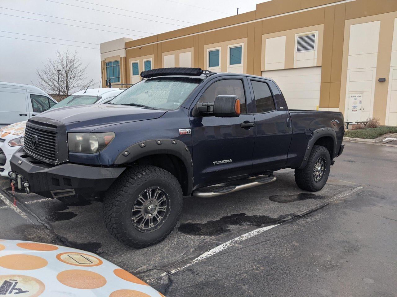

    ^^^what he said. That bumper is also going to add to your curb weight and take away from your payload.
    I'm going to go out on a limb and say you do not have a Rock Warrior truck. That bedside sticker looks very suspect lol. Plus, the RWs did not have any badging on the front doors--so no TUNDRA like yours has, neither did they have anything on the rear of the cab where you have the SR5 badge. Also, as already mentioned, that blue color was not offered in the RW trim.

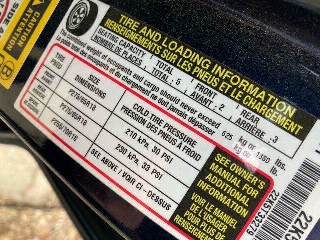

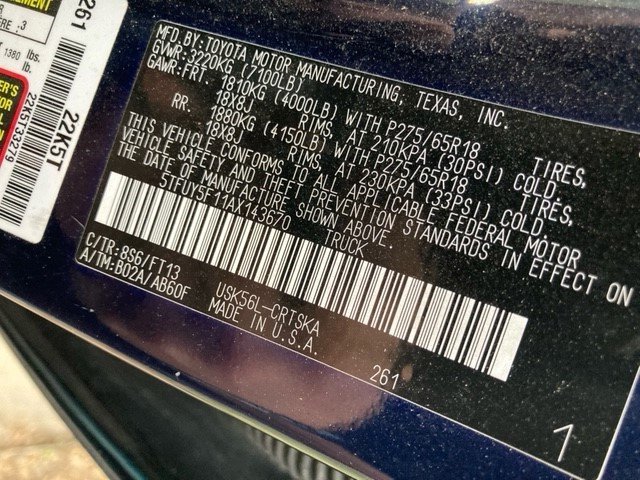

    I looked up the manual from your website and found the exact model and towing capacities for my truck (truck3).
    (The 8300 towing capacity is for trucks that do not have the towing package installed and the 10300 towing capacity is for trucks that do have the towing package; mine has the towing package, therefore a GCWR is 16000 lbs)
    The 2 stickers are from the side of the truck (truck1 & truck2) - 7100 GVWR.
    Picture 2 says:
    "The combined weight of occupants and cargo should never exceed 1380 lbs" - Is this my actual payload capacity?
    And would the tongue weight of a trailer come out of this number?
    The highlighted numbers are from the website that @Hbjeff recommended (truck.jpg) but since i have the towing package, does that make the 1380 lbs the new payload capacity?

    Yes, you are on the right path. The manual is okay, but sometimes can be a little generic in its capacities. The sticker says you have payload of 1,380. Basically, this is saying you have a truck that weighs 5,720 pounds with 0 accessories front the factory (7100-1380). With cargo, passengers, tongue weight, gear the Tundra is good for 7,100 pounds.
    Only way to know is go weight the truck. I will bet you with a full tank of gas, you in it it weighs 6,100 to 6,200 pounds. I see aftermarket wheels/rims, and bumper that probably adds weight. That will leave you 900-1000 pounds of true real world payload.
    Only way to know is to go weigh it at a scale. That trailer is going to be very tough if not impossible to keep under payload. If you even care......
