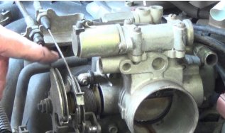

    Easiest 1st step is to check/replace spark plugs and air filter.
    What year is your truck? Maybe take a look at the throttle body cable. If you tighten that it (the nut further up from the finger in the pic), you might get a better response when you push the pedal.
    The throttle body itself can get really gunked up, depending on how many miles you have. Pull off the big, plastic tube that covers the hole above and see what kind of condition it's in.
