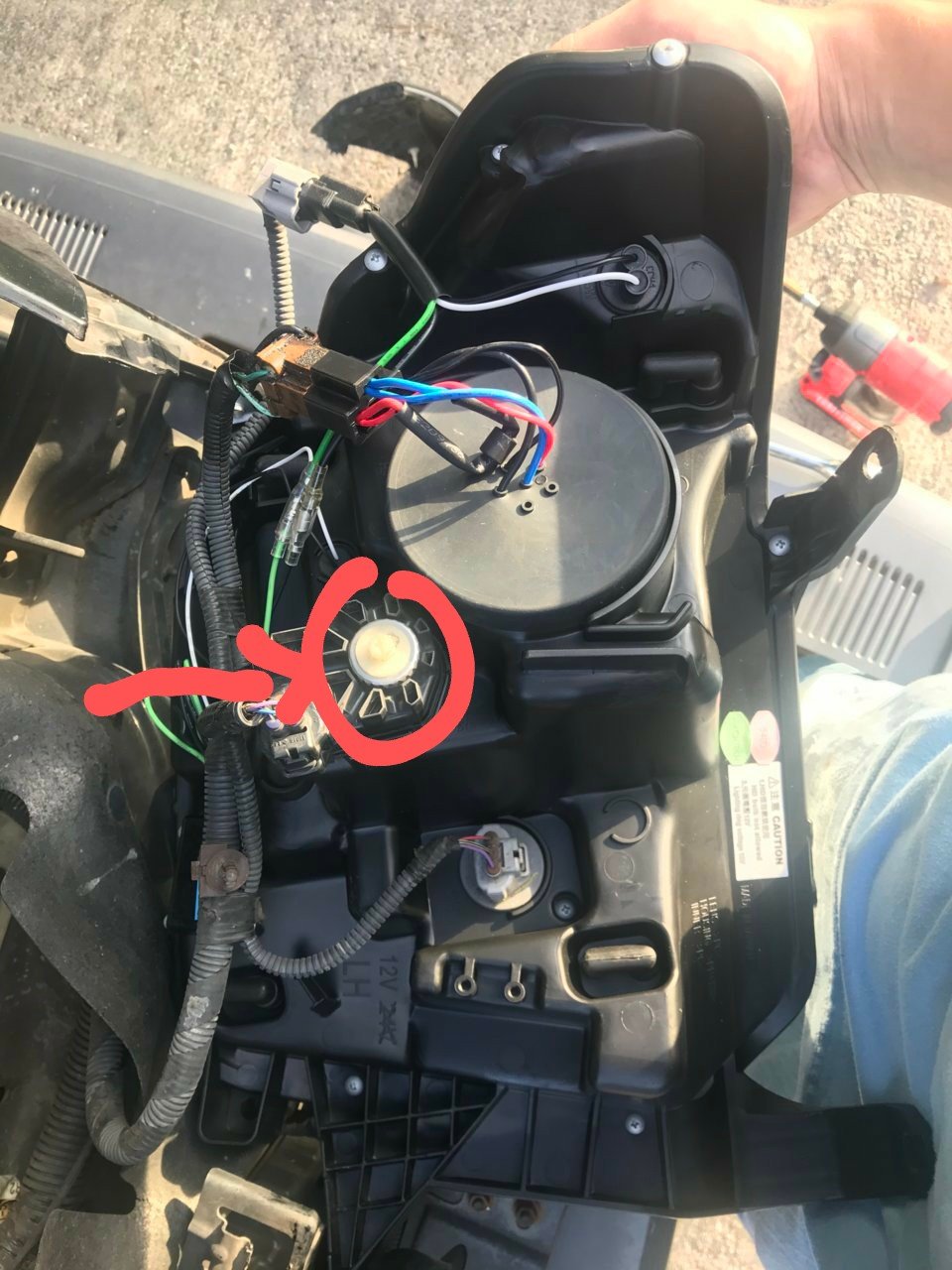

    Thanks ! The issue I’m having is I have only installed headlights before that you manually adjusted height . I cannot seem to figure out how to adjust the height on these that have the connection in back of headlight with adjuster motor on it . The only thing I see is the small screw used to mount this onto headlight itself.

    Can you take a photo of the back of the headlights?

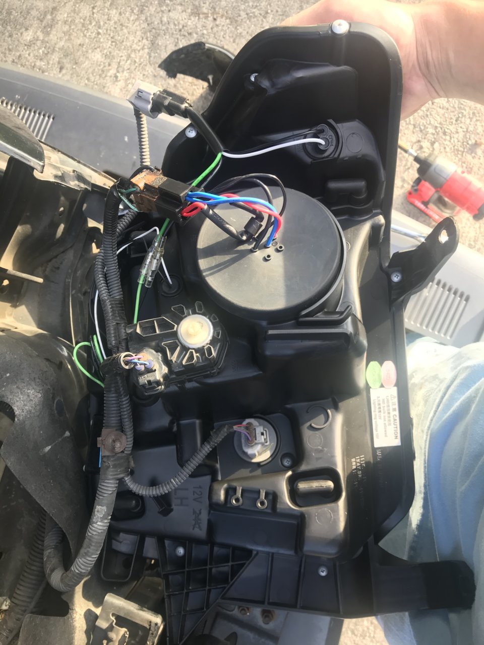

    Here is the back of the light

    Stick a long screwdriver down to this gear wheel. Thats your up and down adjustment screw.E86FFE53-CCD5-4062-B471-BCFF67ADF9F6~2.jpg
