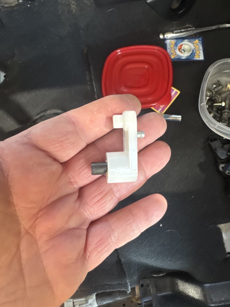

    Need help, trying to replace this lever

    Welcome from NY.
    Here is a hack for anyone that breaks a plastic shaft for a lever on the Hvac assembly.
    1) Drill a 1/8 hole into both side of the broken shaft on both sides. The depth depends on where it snapped.
    2)Go to hardware store and pick up 1/8”-12” round bar and JB weld epoxy 5 minute quickset.
    3)Cut round bar to desired length. Epoxy bar into place on lever side- let dry for +30 minutes.
    4)Epoxy other side of bar and push lever into shaft- let dry +1hr
    5) reassemble
