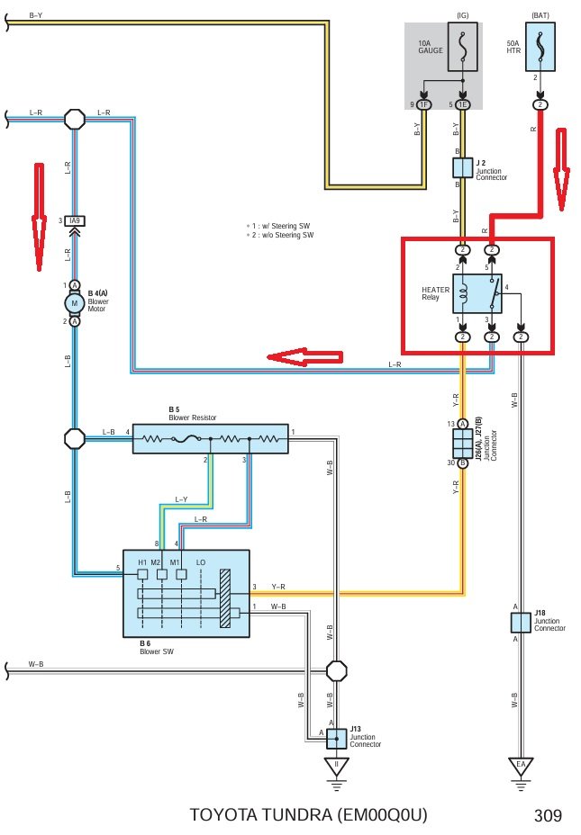

    AC light flashing when energized. I just ordered the Heater Relay 90080-87025 in hopes this is the issue, thanks for this info from a previous chat. Hot air only. Cannot get compressor clutch to engage and unable to charge R134a. Is the low pressure switch on the compressor (multiple wires) connector? Cannot remove the connector. Can I pry with a small flat screwdriver, if I need to short? Waiting for the Heater Relay first of course.

    Have to step out for a bit but when you say "Hot air only" are you meaning blower motor is blowing ?
    If so, your heater relay is energized and thru it's closed contacts, the blower motor receives the needed 12vdc and blows. If mis-understood, back to drawing board.

    The Blower works, hot air blowing since I am in Florida. So, it is not the Heater relay, darn. I did add R134a with stop leak maybe a year ago. The air was cool not real cold until a couple weeks ago. I tried adding more R132a again, but the compressor would not run. I believe the low-pressure switch is on the compressor, right? Can I squeeze a small flat screwdriver on the connector to release it? Which contacts do I jump? If when jumped and compressor clutch does not engage, then the compressor is shot?
