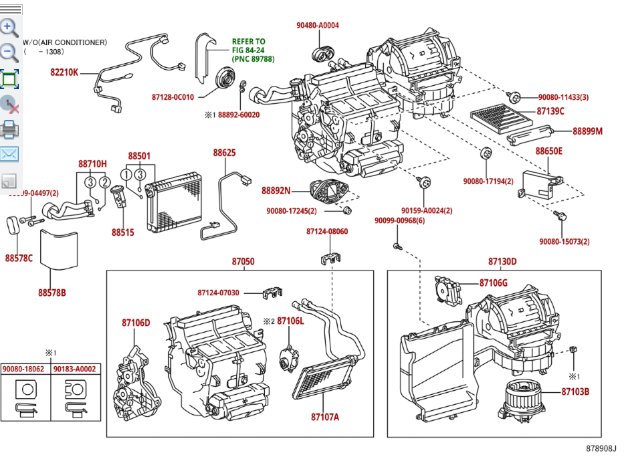

    The dealer said we need to replace the AC Amplifier. We can buy 1 from Toyota directly for $421 or an OEM version for $289 Part# 88650-0C260. I can't seem to find a diagram of where the part goes? Has anyone ever replaced this on their own?

    What was your symptoms? Does anyone know if there is a way to test the amp?

    AC Amplifier Testing:

    I will bet u a six pack that if you just reflow then solder joints on your broken AC amplifier it will resume working again. Cracked solder joints!
