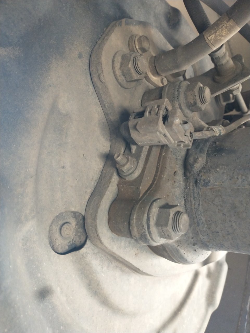

    -Traced all 4 sensor wires looking for damage, chaffing, rodents, etc...: Nothing
    -Removed/Inspect/Clean each sensor: Each sensor and sensor pocket was gently cleaned with MAF cleaner and reassembled.

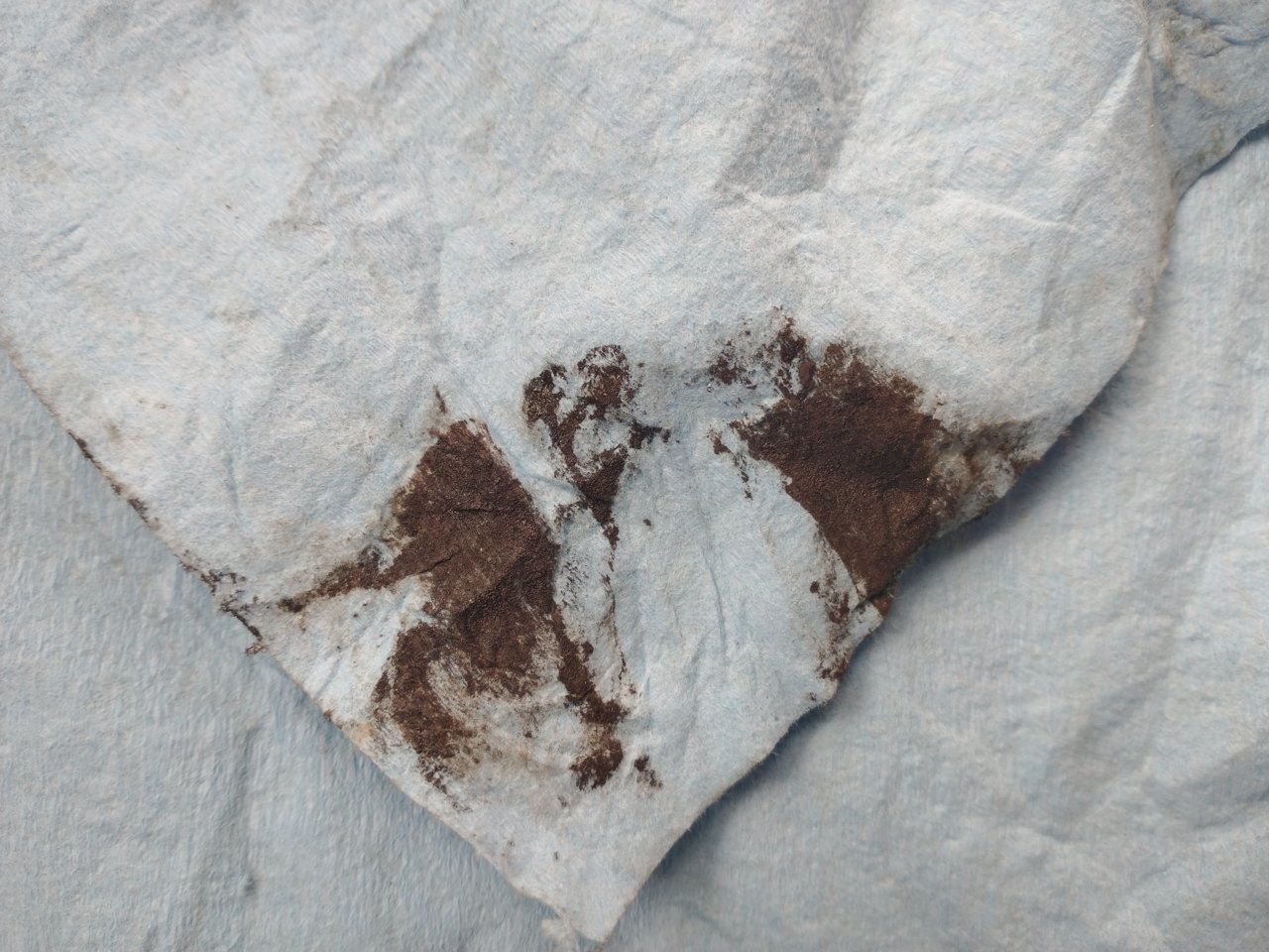

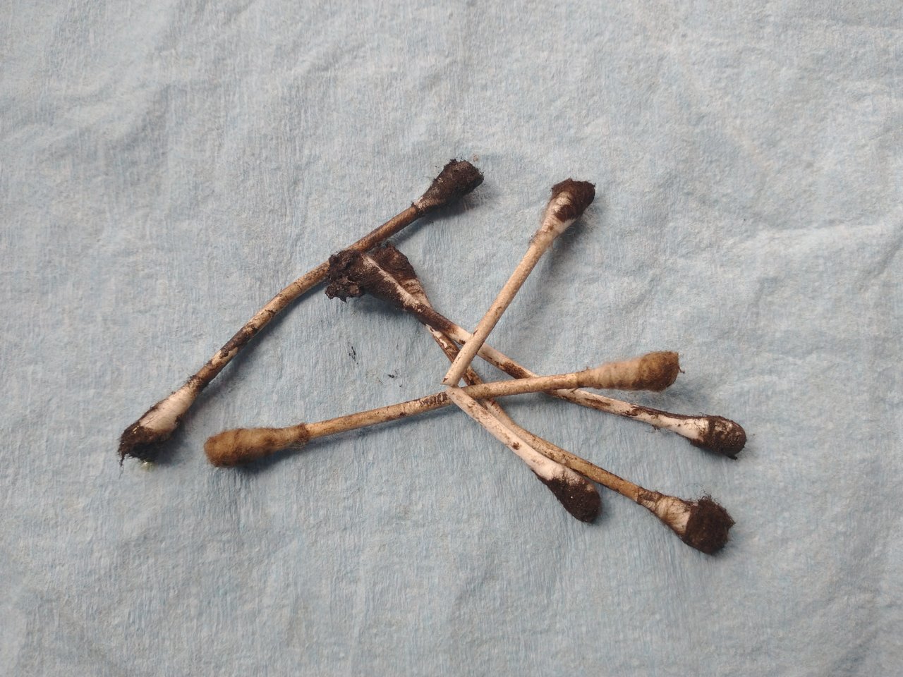

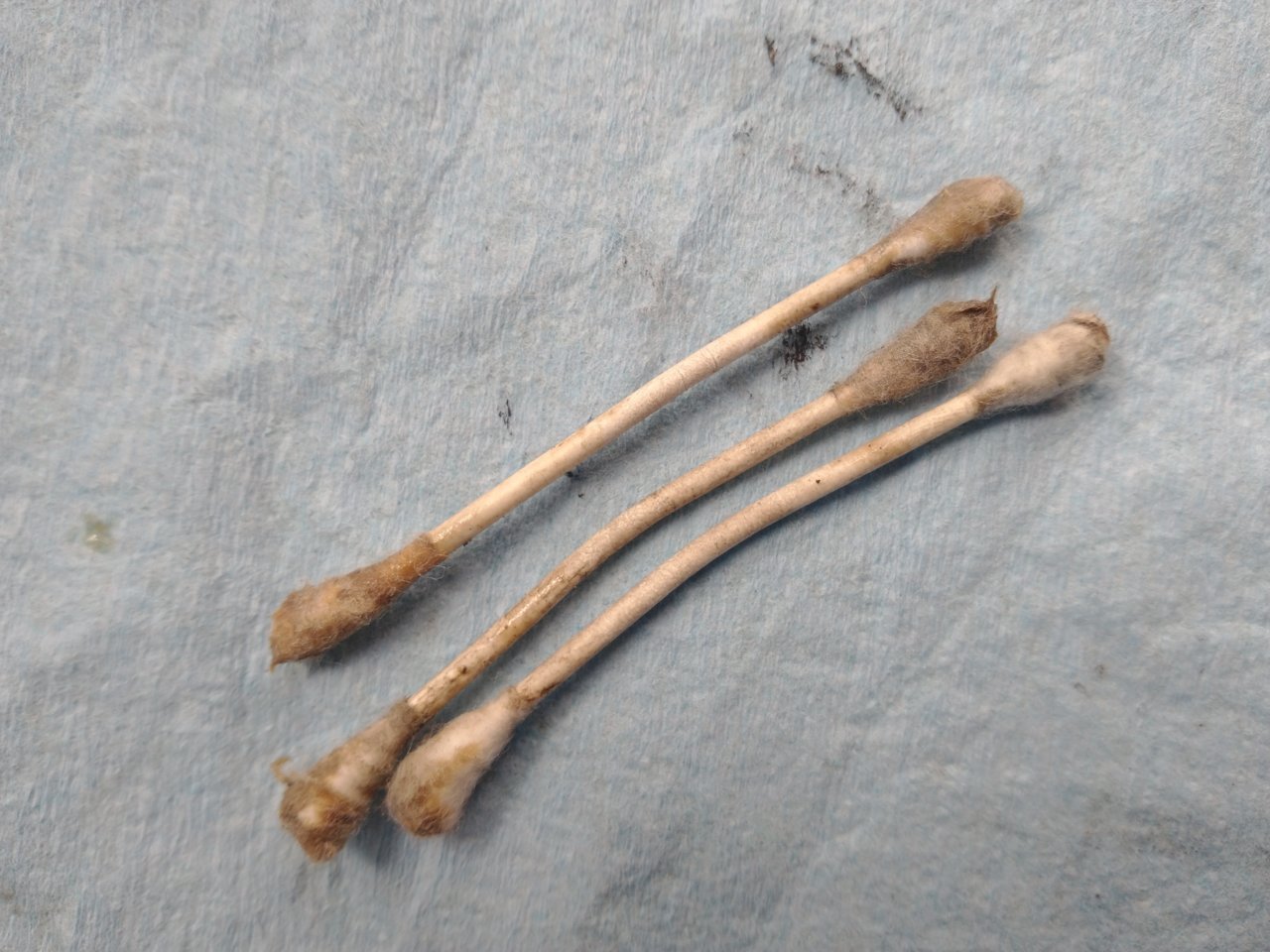

    This was somewhat interesting as I found I probably need to do rear axle seals sometime in the near future as there is a dry, crusty, crud/gunk in the rear/driver side sensor pocket and goopy oil/water mix in the rear passenger side sensor pocket. Front sensors and pockets were pretty darn clean but got cleaned anyway.
    Here's what I wiped off the driver side/rear sensor on the first wipe (no pic of sensor before wiping), and what I got out of the pocket.
    This was the passenger/rear sensor before cleaning (YUCK!).

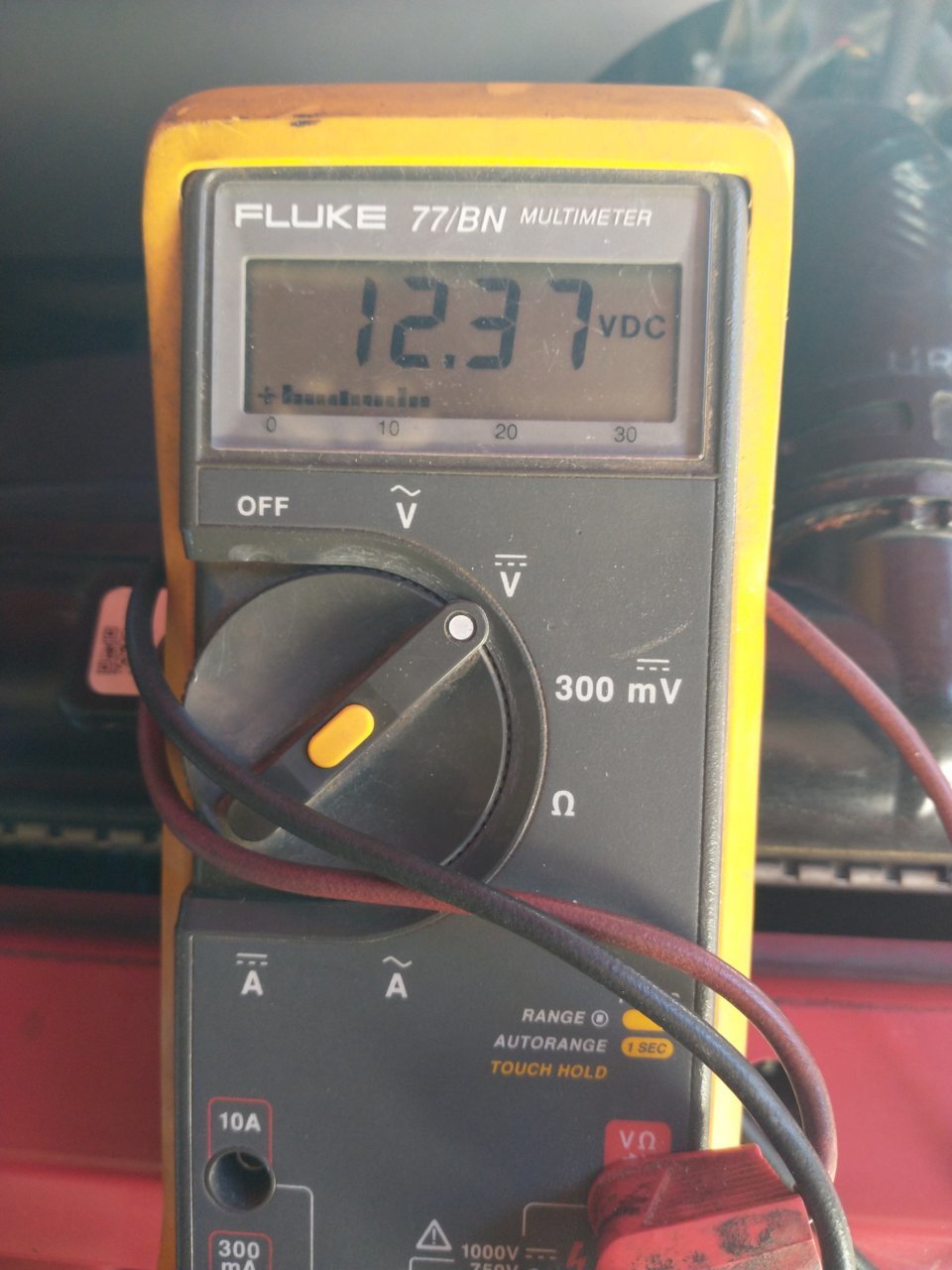

    Voltage right now, after not being driven since last night. Battery date is 9/19.
    Voltage at idle is 13.78.
