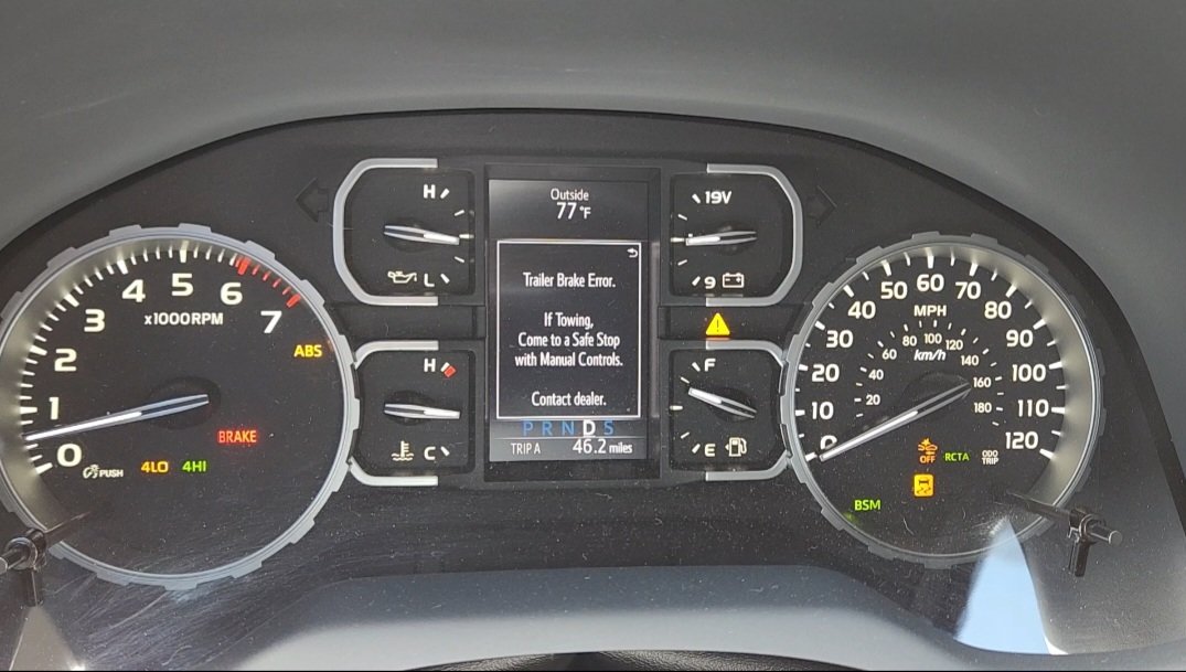

    I bought a 2020 Tundra SR5 with the sport package last week and I'm now having some issues. The vehicle had 32,000 mi on it and seemed to be well taken care of. The previous owner put in the TRD off-road sway bar on the rear and an aftermarket exhaust. Those are the only upgrades I am aware of at this time as the dealer did not give me any information on the vehicle and nothing else jumps out to me as being aftermarket. I picked up the vehicle from Colorado springs and I live in Albuquerque, so I drove up and drove it back just under 400 mi with no issue. Then I towed a buddy's vehicle about 250 mi on Wednesday, I was cruising at 65 mph and the ABS, break, 4lo, 4hi, rear cross trassic alert malfunction, cruise control malfunction, tow breaking malfunction, Blindspot malfunction, drive start control malfunction, and pre-collision system malfunction lit up my dash.
    I immediately pulled over and the tow brakes were working just fine when I did so. I shut off the truck and checked the load and tried to figure out what was going on. After a few minutes I started it back up and all the lights went away. The vehicle then drove fine The rest of the way which was about 70 mi. Then I turned around and came home with no further issues.
    I thought maybe it was a one-off instance until I went camping this weekend and the same thing happened numerous times. Whenever this happens the vehicle runs fine except I can't use cruise control and the malfunctioning systems clearly don't work. I'm good to go with maintenance and most repairs, but diagnosing is not my forte. I don't really know what this could be, I did read another post that it could be the ABS speed sensor but the original poster of that thread did not reply if that fixed the issue or not. Any advice would be appreciated before I head off to the dealership. Sorry for the lengthy post, didn't know what all would be important in the situation.
