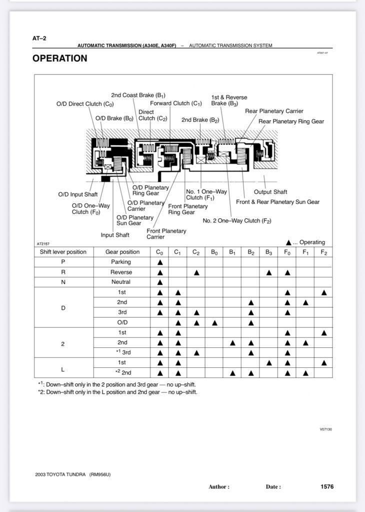

    Oh, I found this neat little diagram
