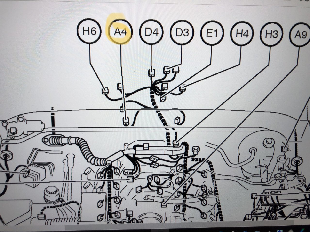

    Hey y’all haven’t posted in a while but just here with a question about the A/T oil temp wire. Doing a PKE/push to start and need to splice into it so the system will work. I saw it was a YR wire so I pulled out the dash to try and find it, I found the wire but noticed it was un plugged and the AT light was still on. Appreciate any help I can get and thanks in advance.

    If you download the Full Service Manual on this site (stickied post called “So…you wanna buy” has a link to it) and control-F for “oil temp” you can see all the times it’s mentioned. For example, there is a link to this picture which is the closest thing to a physical location (it’s at A4) and a bunch of wiring diagrams that show its relative location.
