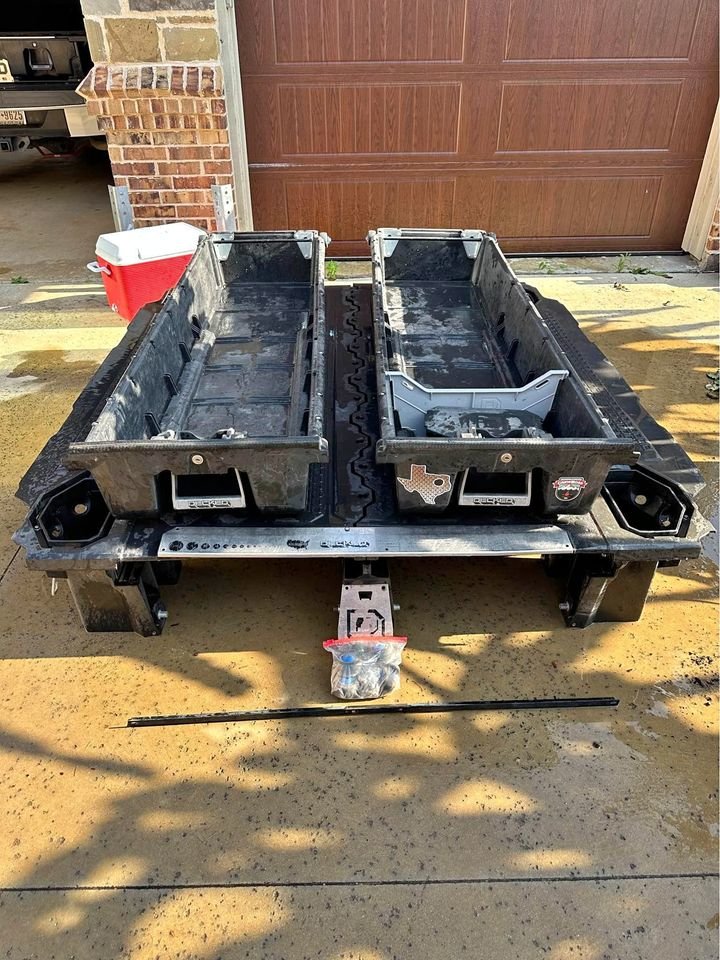

  29. Jul 11, 2024 at 12:47 PM
    #29
    The Black Mamba
    Sep 6, 2023
    #103472
    5,331
    BlackSnek
    Flower Mound, TX
    Black 00 SR5 AC 5VZ PreRunner
    Imma keep it stock
    I would believe this to be a FGT 435112818_911159184143276_81927804155802_9d4798bb136697721e2c83c1b184a3adb7035866.jpg
  30. Jul 11, 2024 at 12:50 PM
    #30
    shifty`
    Jun 20, 2020
    #48239
    31,538
    ATL
    '06 AC Limited V8/4WD
    Ah yes, looks like a DC. The link I gave above only works for AC. @Vader03 is an '03, so AC or RC (I'll assume best cab/AC)
