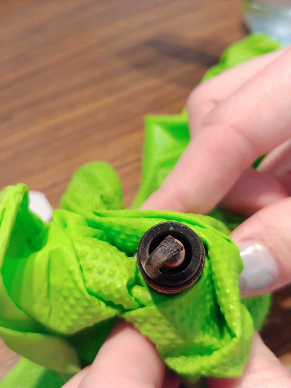

    I've also had experience with counterfeit OEM iridium plugs purchased from Amazon. They even came in Toyota/Lexus packaging. They worked OK for a while, but then started misfiring. Upon removal and inspection, the electrodes were practically gone, and the gap was HUGE. I swapped them with a legit set from Rock Auto (NGK or Denso... can't remember which. But both brands are listed as OEM in the manual.)
    @Beefnbread Where did you get your plugs? What brand? Did you replace them at the same time as your injectors?

    Here a pic from the incident I referred to above. These plugs are from my wife's Prius. While it is a hybrid, the engine is the typical Toyota 1.8 liter inline 4. It takes Iridium plugs that are good for 120K miles. The plugs I removed had about 110K miles on the and the iridium tip looked brand new. If you know iridium plugs, you know the electrode is tiny and comes to a sharp point. That's what these plugs looked like when I installed them. Here's what they looked like after 20K miles. (and causing severe multiple misfires.) Look at that second one from the top. The electrode is almost gone! :eek2:
